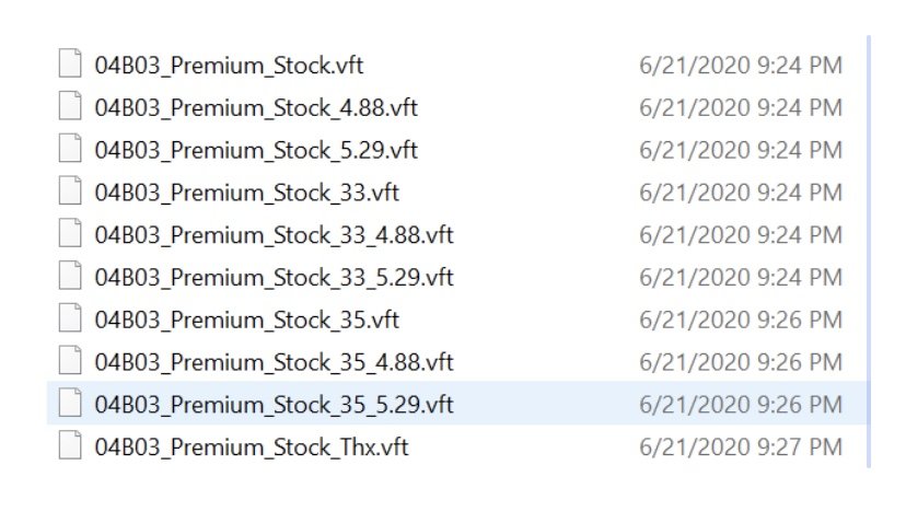

  1. Nov 30, 2020 at 11:28 AM
    #8581
    zooyorkajd
    zooyorkajd Well-Known Member
    Jan 13, 2014
    #120543
    240
    How do I understand what each file is?
  2. Nov 30, 2020 at 11:51 AM
    #8582
    N5J_Taco
    N5J_Taco Well-Known Member
    Oct 29, 2020
    #345235
    331
    New at this myself but here is what I gather:
    04B03 is your ECU ID
    Premium/87 is for fuel
    Gears are Stock/4.88's/5.29
    Tire size Stock/32 inch/33 inch/35 inch
    THX is for Enhanced (More aggressive) throttle Management
    Greatdane01 and ktbell444 like this.
  3. Nov 30, 2020 at 11:55 AM
    #8583
    dave5623
    dave5623 Well-Known Member
    Sep 29, 2019
    #306642
    336
    2020 TRD Pro
    Interpreting your key and looking at that screenshot @zooyorkajd posted is the one labeled 04B03_Premium_Stock_35_5.29.vft apply to both stock and 5.29 gears?
  4. Nov 30, 2020 at 12:02 PM
    #8584
    ktbell444
    ktbell444 One who throws exceptions
    Aug 8, 2017
    #226306
    2,969
    ᚺᛖᛚᚺᛖᛁᛗ
    No, I think "stock" is used to apply to either gearing, tire size, or thx.
    So the example you listed would be 35" tires, 5.29 gearing, and stock (stock for OV) throttle response.
    dave5623[QUOTED] likes this.
  5. Nov 30, 2020 at 12:03 PM
    #8585
    dave5623
    Sep 29, 2019
    #306642
    336
    2020 TRD Pro
    Hard to know when the word stock can be applied to almost every field. Thanks!

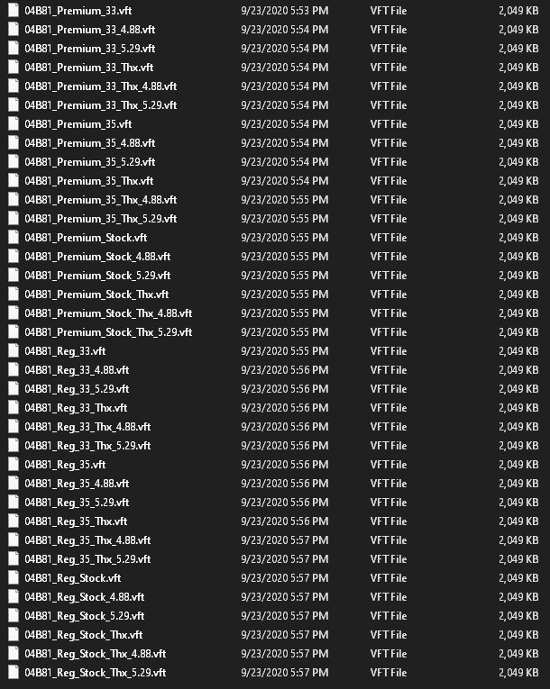

  8. Nov 30, 2020 at 12:08 PM
    #8588
    ktbell444
    Aug 8, 2017
    #226306
    2,969
    ᚺᛖᛚᚺᛖᛁᛗ
    My 04B81 tune pack only states "stock" for tire size.
  9. Nov 30, 2020 at 12:09 PM
    #8589
    tonered
    tonered bartheloni
    Sep 25, 2017
    #231055
    31,190
    tony
    Lynnwood, WA
    I believe it is a file naming error. This was posted in the Dev thread a while back:
    Note that you can check gearing and tire size (radius) in vF.
    johntoyota, ktbell444 and dave5623 like this.

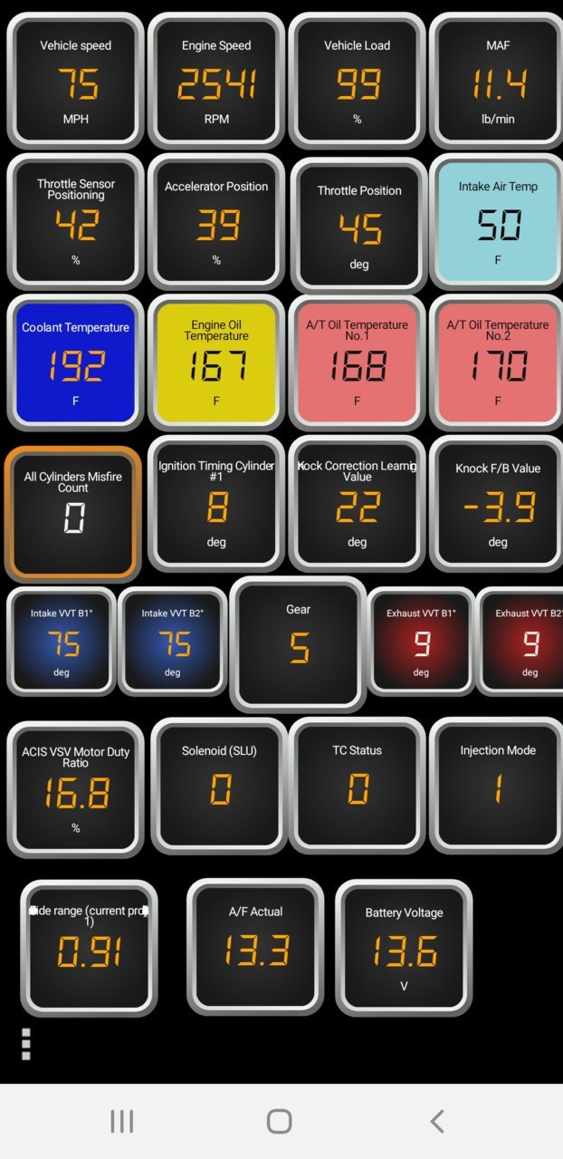

  16. Nov 30, 2020 at 8:37 PM
    #8596
    Vlady
    Vlady Well-Known Member
    Dec 20, 2017
    #238986
    4,514
    Issy, WA
    2017 White SR5 DCSB V6 4x4
    Today i hit 99% in 5th on the steepest part and it did not downshift..
    This tune sucks gas though.
    I think airload changes need some revision

  19. Dec 1, 2020 at 3:32 AM
    #8599
    dunlap837
    dunlap837 Well-Known Member
    Apr 8, 2020
    #324170
    464
    2018QSDCLBSR5
    Enhanced Skinny Pedal
    Thanks for the update. Report back, please, if you manage to claw some mpgs back while maintaining the drivability characteristics. I have also experienced running high load / low rpm to suck gas. I assume this is why toyota tuned it to downshift all the time, but would be nice if that operating range can be made more efficient.
  20. Dec 1, 2020 at 7:57 AM
    #8600
    Frank_Zuccarini
    Frank_Zuccarini Obscure Member
    Apr 27, 2015
    #154073
    435
    Frank
    Chicagoland
    AC-TRD-OR-4x4-Barcelona Red
    That is a really nice data display you’ve created. Lots of very important information, and I like how you centered and enlarged the current gear indicator.
