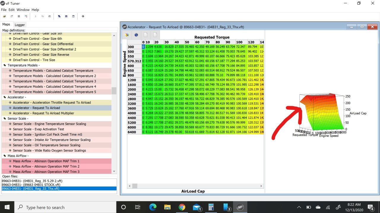

    Has anyone dug into the torque model table yet? Any other big discoveries yet? I remade my 91 tune in 85 and somehow I made it drive better than my premium tune. Also has anyone messed with the request to air load table yet? I'm wondering of smoothing out the top would do anything

    I'd have to imagine that this dip is limiting torque/throttle in the lower rpm range

    Look at the RPM range for that dip. it's idle. Not affecting any actual driving range
