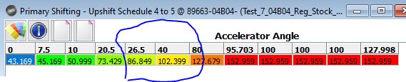

    k. here is a scenario. Entrance to freeway with immediate 3 mile very steep climb. My speed was 53-55, 4th and accel % was 30. The tranny wound not go to 5th. So I switch to S and forced to 5th. Tranny went up and down to 4th. So back to D and press the pedal more while climbing. I reached 38 on accel when the upshift happened. My speed was around 60 mph
    Here is 4 to 5th upshift table. 102 kph/1.6=63.75mph , at 38%- ~62 mph and this is close to my travelling speed

    More wheel speed per rpm. There's no factory locker available in 4 high. Just spitballing. Locker anytime mod on my first gen was stupid easy. Ground the gray wire. That made the truck nearly invincible in the mud compared to no locker, or having way less wheel speed while in low 4. Although that was a manual, so I could get more out of it without bouncing off the limiter.

    Tune: Nexus +P Add ons: +3" custom suspension 295/70/18 Yokohama M/T Tires KMC XD Grenade OR wheels KN intake Blackhawk MBRP Exhaust TJM Rock Crawler Bumper Lighting (+10 H.P.)
    @OVTune
    The upshifts did align with my primary settings. What cuts out 4th and 5th? What determines the downshifts? Nowhere near my primary settings... If you do not have time to answer. That is fine. I'm just discussing. Not expecting a personal tune session.

    Ahh for the locker.
    I can put it on the list to look into. But I'm certain 4Low tables are primary, and the ECU sets a bit flag where "if 4 Low, upshift request sll / slr 0xBF 0xDF etc " etc (which translates to 4th). Basically the ECU sets a bit in RAM that says "when active ignore any shift request above 4th"
    it would require a custom patch.

    Gotcha.
    Upshifts are spot on with primary. Downshifts are certainly coming from somewhere else. I was just trying to think of a way around needing the locker anytime mod. No biggie. Thanks for letting me know not to waste my time trying to find something that I could never currently complete. Greatly appreciated! :thumbsup:
