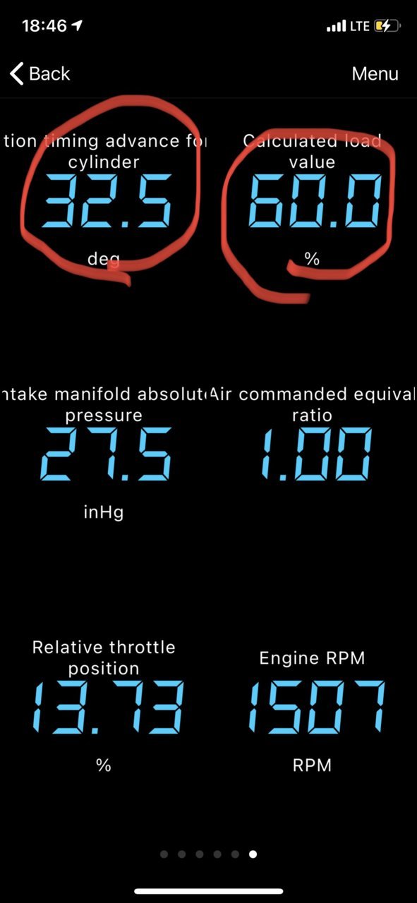

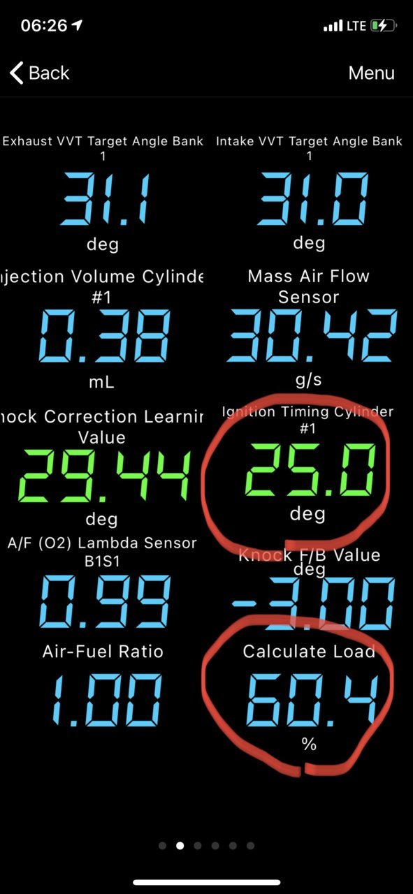

    Some food for thought, curious what you guys think about this. Did some monitoring between my taco and the bro's 3.6L in his grand cherokee. These two snapshots are within the same ballpark of RPM +/- 100. Load just about matches up perfectly, yet ignition timing is almost 10 degrees apart (the taco being the lower one, and it feels like it). And I'm on the premium juice too... I get that they're two completely different engines but still.. Am i making a case here or do I just sound off my rocker..

    Whats the compression ratio on the jeep? I’m no expert but I would think that plays a role.

    Its the 2018 which I believe has 11.3:1 so not far off from ours. Probably close to the same after our VVTi-W lowers our compression ratio at the low-mid load range..

    Each manufacture has its own logic for calculating load.
    So it doesnt mean much.
    Full throttle timing is the only timing worth. Comparing

    1. 16.07843
    2. 16.07843
    Calculate Load (%)
    1. 58.82353
    2. 58.43137
    Ignition timing advance for #1 cylinder
    1. 20
    2. 23
    Eng RPM
    1. 1916.25
    2. 1919.50
    Sorry trying to make it easier to read. Here are some of my numbers close to @ForceOfG.
