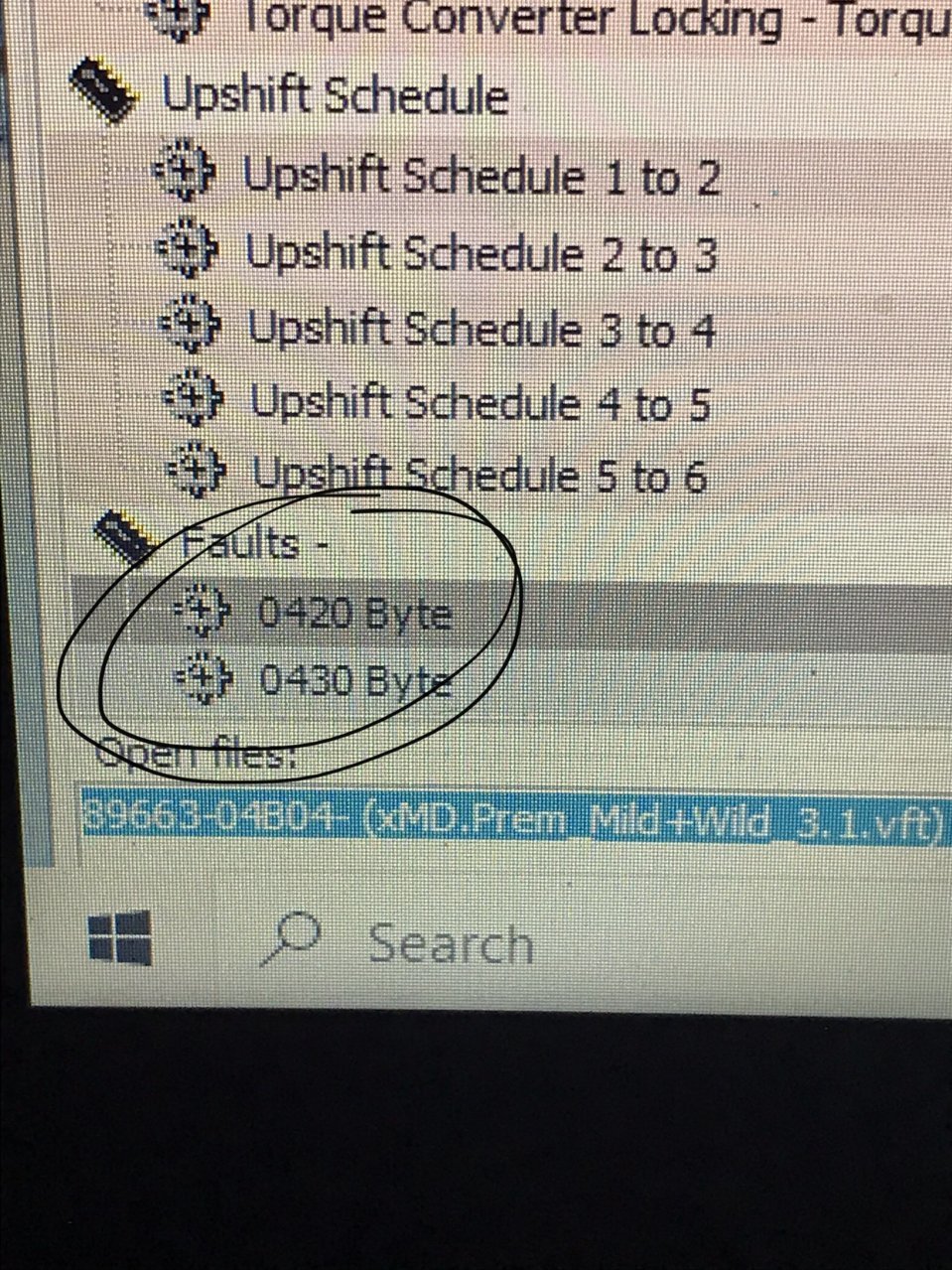

    I’ve purchased the 3.5 tune pack and catted dump tubes. I’ve already got the urd u spec exhaust. Should be putting the tubes on this weekend. I need a fix for the cel’s. Also I’m running the @Mooseditty17 m+w with @PapaRee 93oct twist. Much appreciate a response guys. Will throw some cash if anyone can help. @Tac0Tic0 @OVTune @tonered

    Simple fix for dump tubes- change the last 2 values (scroll all the way down-last 2) in Vftuner to 0. No CEL.

    This? Also read somewhere that there’s a cattless tune that runs good with the urd exhaust Bc of the 2nd catts r deleted.

    Yes those.

    That’s the ones.
    I don’t have a copy of the cat less specific tune. But I think @Tac0Tic0 was running it. He may have a copy.
    But I would imagine that the mild+wild 3.1 would be better for performance.

    Have the older .bin files of the dump tube tunes if you can run those. But I don’t think @OVTune made any adjustments to the tune itself other than eliminating the faults so there wouldn’t be any DTC’s generated.
