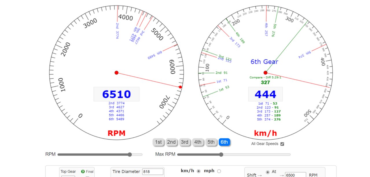

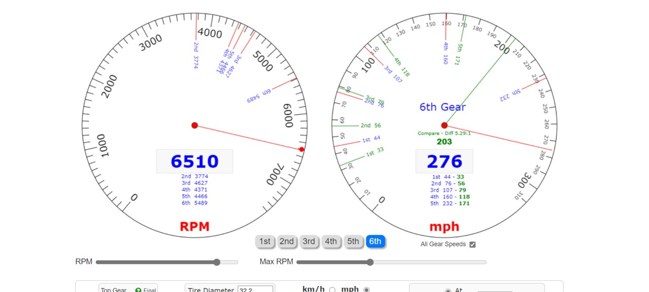

    If it's that easy great, but was thinking that the shift tables (i.e. accel angle/kph) would also need to be changed.
    p.s. this is a pretty cool Gearing Calculator
    I used these to set max accel shift points so that my truck wouldn't go all the way to the rev limiter when WOT. Next step it to set other tables to make the accel*/kph shift points more linear
    Example: Theoretical WOT and shifting at 6,500 RPM just before the rev limiter of 6,800
    Stock (blue) to 5.29 (green) in KPH (top)/MPH (Bottom) on 32's.
    I know its accurate to 115 mph in 4th gear. I did this plenty of times when troubleshooting the 80 mph limit for 5.29s until Mat fixed it - I could do 115 mph in 4th but when the truck shifted to 5th and 6th it would be governed to 80 mph.
