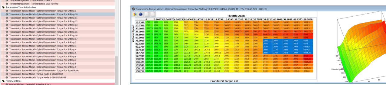

    Since a lot of you guys are having this issue.
    Find these tables, log the vehicle speed and the throttle angle you're at where it won't upshift.
    on these tables, find this area and increase the values.
    Alex281, Saeros, Mooseditty17 and 3 others like this.

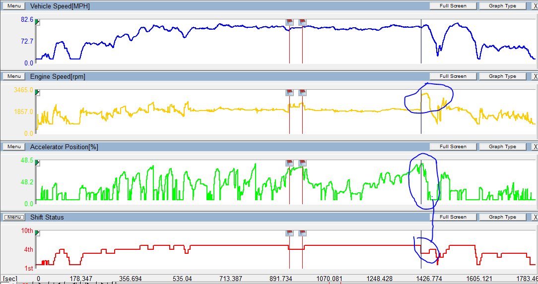

    I've dialed to stop dropping to 4th on steep inclines and speeds between 70-80. In some cases I've managed to keep in 5th with 99% of the engine load.
    But my changes reach the limit on very steep and long inclines where you do need 4th to keep up with the traffic.
    I have been playing with the pedal to force upshift -here is a good illustration. Accel went from 48 to 0 and still no upshift. Upshift happened when RPMS calmed down to 3000.

    I see what you’re going thru now. I have not experienced that, but certainly I would be very frustrated if I was.
    So I also think I understand why Mat recommends increasing the transmission torque to fix this problem. The ECU is waiting for engine torque to come down to hit the threshold specified by that map. By increasing the shifting torque the engine torque does not need to decrease so much.
    Is there a PID we can monitor to understand what the requested torque value is? I am wondering if I am going through the inverse of this where I am getting downshifts sooner than I’d like.

    The raising the torque for shifting makes sense now with your explanation. Now I’m just curious as to how much to raise it.

    What are the units for vehicle speed in these maps?

    In the past I used generic Engine torque pid, which was no near real numbers.
    I will try Toyota's pid "real engine torque" to see if works.

    I deliberately tried to reproduce your issue heading over the mountain on the way home tonight. I was able to replicate it several times. Hadnt bothered me before because in the given situation I would not want 5, but I could not get it when I tried even with 0 accelerator and speeds above my shift curve.
    Thanks for bringing this up, something for me to keep in mind as I continue to refine my shifting.
