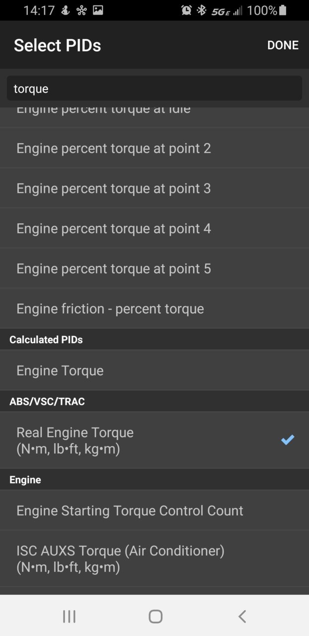

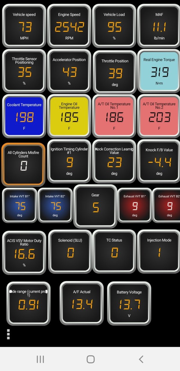

    Ok. This Pid works and polls the data(blue).
    1st- the data in the table is Calculated 4 digit torque value. Based on the load I can say that calculated and absolute are very close values. If I were messing with the table, can I really reference the real data to the values in the table?
    2nd- Am I 41 nm away from the engine's max published torque?

    What app is that?
    And interesting that your exhaust valves are only 9 degrees advanced when the maps available show a lot more advance in that rpm and load range.
    The intake valves look like they match the values.
    Maybe that's what @OVTune was referring to in previous posts about the exhaust valves retarding?

    OBD Fusion.
    The valve thing is above my pay grade.
    This is 2.0 tune. I can look at my old logs to see beta version, but I believe the numbers are the same for exhaust vvt

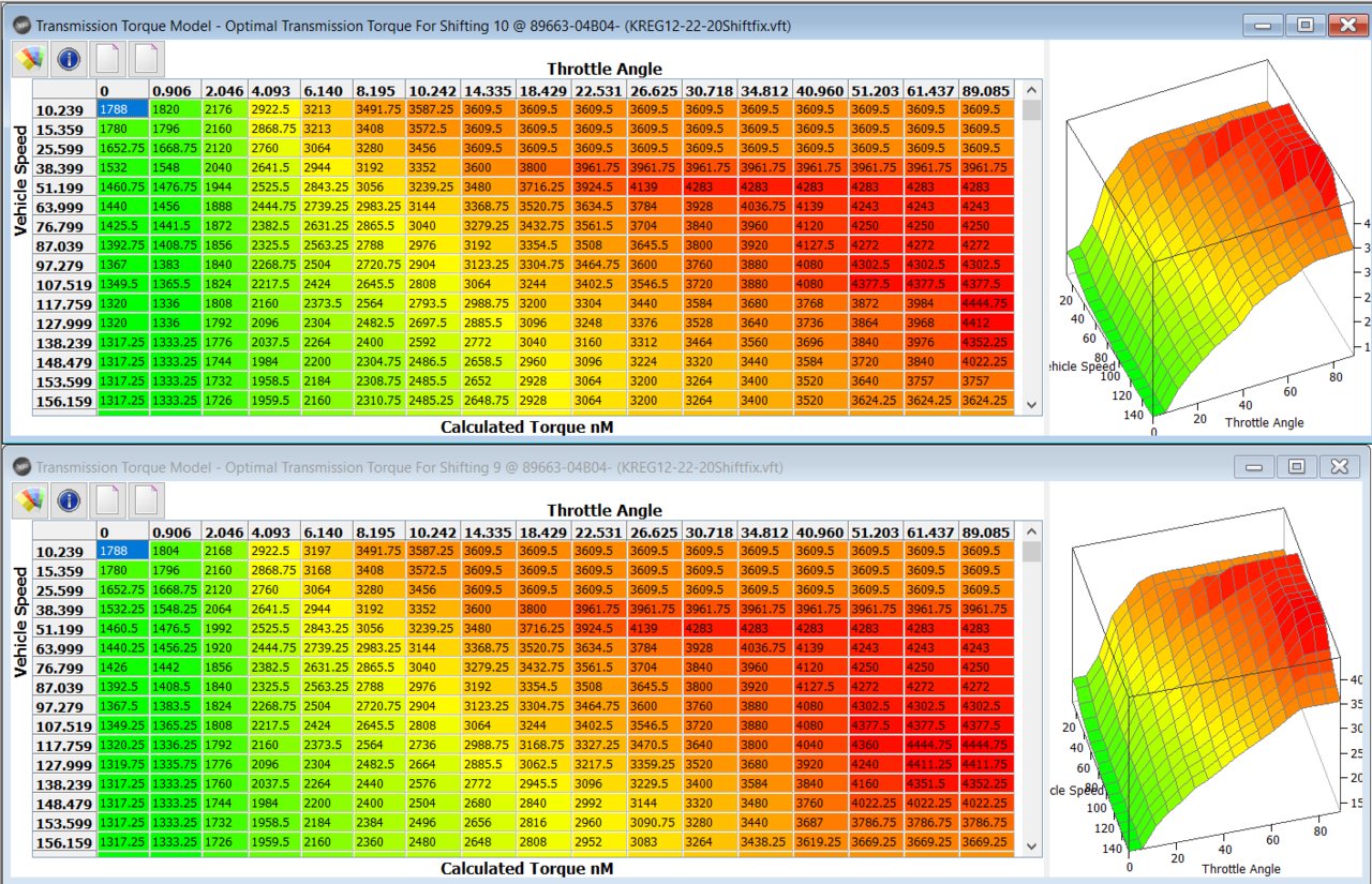

    Did you guys notice on the trans torque map Mat brought to light, That It's the only map in all of the trans torque maps that have that huge crater in the middle? He is having us up the very top of that map. so my question do you think if we make it more like shift 2 for example would it shift like any other gear/load? And take out the huge dip in the middle?

    I wasn't sure how much to increase the shifting 10 map, so I looked at all of them and copied shifting 9's values (which were a little higher) to the shifting 10 map. Flashed it today and drove around. No big difference, but no problems either. I'm going to give it a few miles to see.

    OK nice!! keep us posted. I am upping what Mat highlighted by 3% and smoothed the dip but nothing else. there is still a dip but more of A U shape then A V.

    Actually you are correct.
    I looked at my old beta version logs and close engine load I see is 89-90 % and at these values I see Intake around 68-69 and Exhaust around 22-25. But RPMS are low though. Around 2100

    my truck is plagued by the high load 2k rpm area lumpy feeling. And when this happens in second gear, the whole truck jumps like a dump truck that almost stalled, its horrible. Mat said he found an issue in the way the factory deals with exhaust VVT causing them to retard. He is working on a patch for VVT i believe, or at least putting the maps in VF so we can play with them.
    I just noticed since you literally screen shot the high load, lower rpm, with a retarded exhaust vvt value that i would quote it and see if it was what Mat was speaking of.
    I also notice, the exhaust VVT maps we have now only go to a load of 60, whereas the intake go to like 150.
