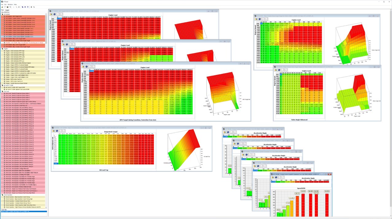

  12. Dec 23, 2020 at 4:38 PM
    #9032
    OVTune
    OVTune Well-Known Member
    Mar 27, 2017
    #214557
    8,112
    OVTune
    *some* stuff coming to 2.0 Performance EROM
    see more here
    https://forum.vftuner.com/forum/toy...-fks-upcoming-vf-tuner-custom-feature-patches
    Happy holidays.
    VFT EROM Support for 2.0 Performance.
    Table Access includes:
    - Map switch channels
    3 Map Channels
    Map channel 1: normal / D / nothing activated
    Map channel 2: ECT Mode is active
    Map Channel 3: 4 Low Selector is Active
    Tuneable Parameters
    Cruise Control Shift pattern (upshift and downshift)
    Map 2 -
    - AFR Target
    - Valve Timing Target - Intake
    Map 3 -
    - AFR Target
    - Throttle Request Target
    BOMBS, GPatriot, ihatemytruck and 6 others like this.

    Hey i have a valve map that looks similar to the bottom right one

  16. Dec 24, 2020 at 6:30 AM

    Anybody know what "Map Channel 3: 4 Low Selector is Active" is going to mean? Im sure I missed something but I dont get it.
    LstMinutePanic likes this.
  20. Dec 24, 2020 at 8:57 AM
    #9040
    lapoltba
    lapoltba Full Bridge Rectifier
    Aug 28, 2014
    #137089
    3,346
    CT - 06076
    '17 Sport, ACLB, V6,MT, 04B14 OV-Tuned
    Probably active when you're in 4 low.
