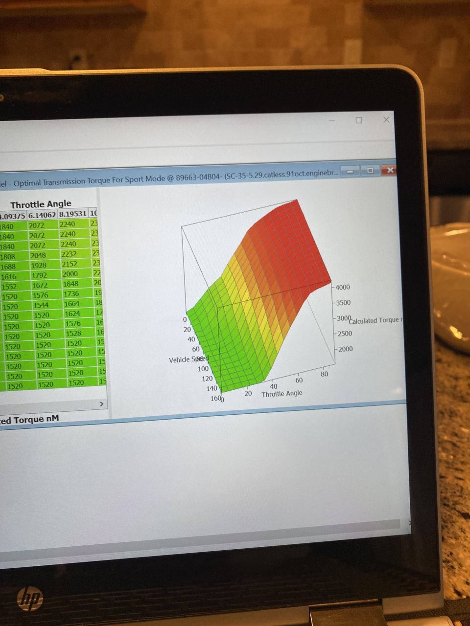

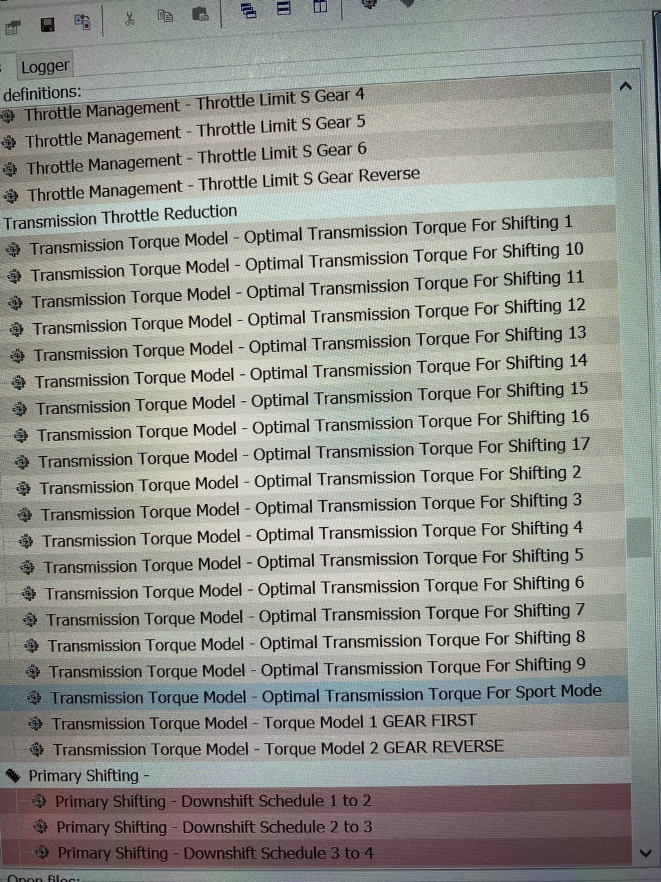

    Has anyone played with Implementing the sport mode shift map into others like 2-3-4? To get more of a sport feel down low? if the 2-3-4 are low speed Scenarios. Also looks like 2 and 14 are super similar same as 3-15 and so on with very little differences. Any idea to why?
