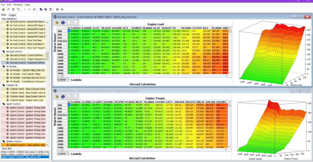

    Let me know what you want. Here is the lambda .999 maps for those 2 in 04833 2.0 reg.

    Tell me that control airflow .999 doesn't look suspiciously like our adjusted maps for 04B04...

    They are a bit different still. I keep going back to the settings of Mats 2.0 tunes there is something that feels right when you don’t mess with them. Idk about performance but the throttle feels better and seams to hold gears better before I started playing with the air tables. It’s like you adjust one little air table and it changes 3 things throttle, shifting, and torque

    Thanks for that.
    I didn't look at all the numbers; but, all the numbers I did look at were identical to stock 04b04 (and 2.0)... am I missing something?

    I was confused by Mooseditty17 comment ...
    The numbers are identical to stock B04 ecu.
    Id like to see 19800 ( Fall 2019) in vf format

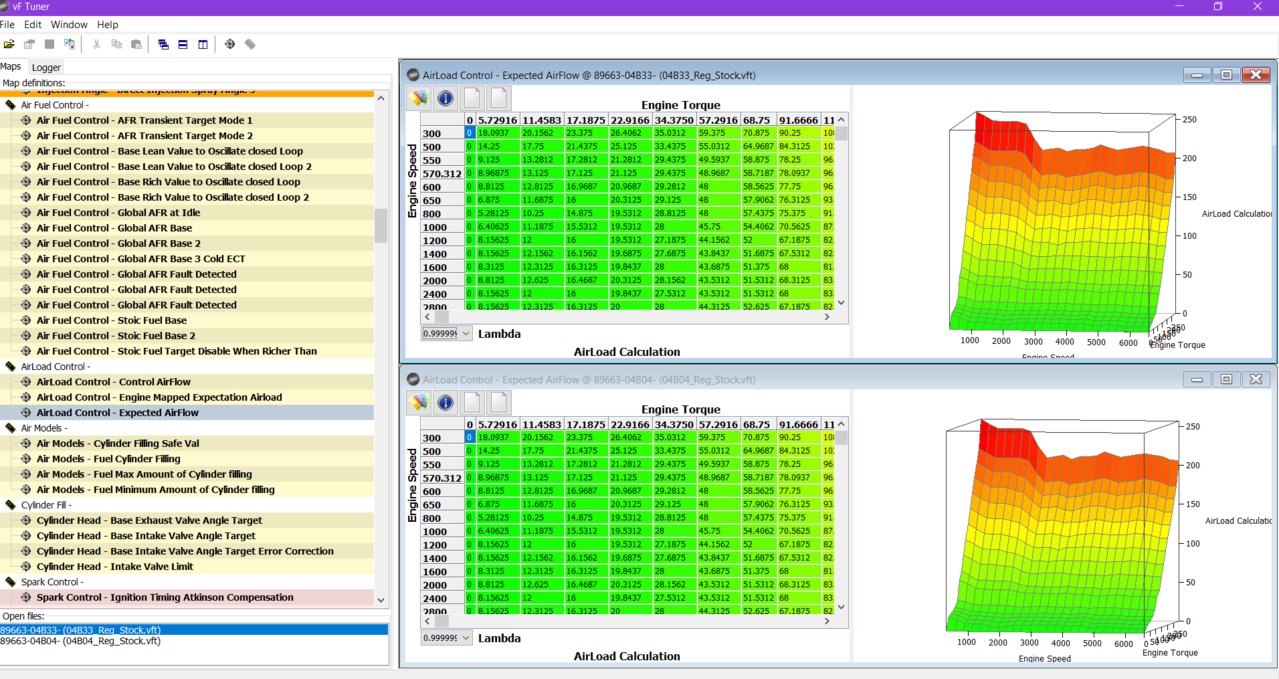

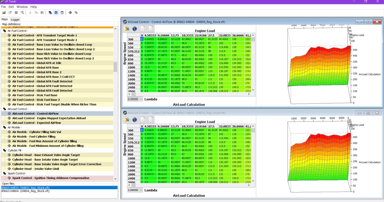

    You are right. Here is 04b04 vs. 04b33 lambda .999

    So in the Airload examples Mat gave us, all we did was changed both lambda tables to be the same as the .999?
    For control airflow anyways. I'm purely going of mental notes. Nothing in front of me to verify.

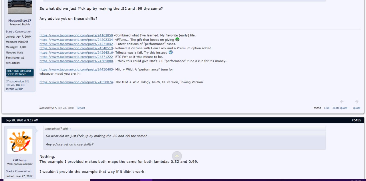

    I searched the old posts and found this
