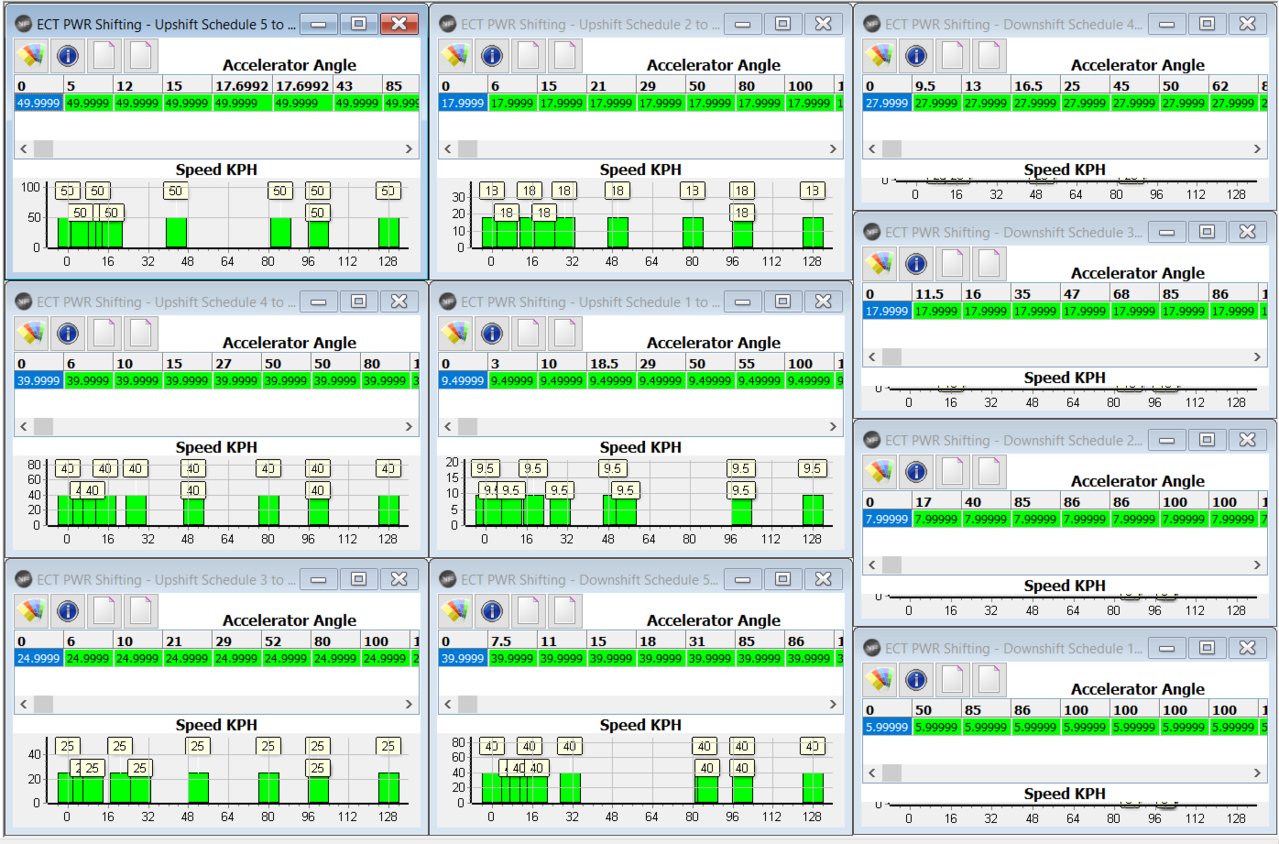

    so i'm finally getting around to setting ECT as gearlock. do i just do this by setting ECT downshift maps to "0" ? but which part do i edit? i'm new in vftuner. do i edit under "ECT PWR DOWNSHIFTING SCHEDULE 1 to 2, 2 to 3 etc all the way up to 5 to 6. do i just change all the tables 0, 50, 85, 86, 100, 127.98 all to 0 and save?

    I pulled up my last gear lock tune and here are the ECT maps. Just use thes numbers.

    Nice. I did flash with the ect downshift maps all values 0 and it seems to be working perfect so far. What would be the difference with your values? I’m guessing it just allows it to downshift only at almost 0 pedal?

    Yep, exactly.
