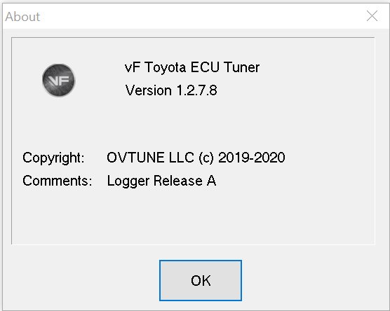

    Hey... I just downloaded vF Tuner from OVTuned.com and it showing as 1.2.7.8 :thumbsup:
    Edit: Sorry if this is already common knowledge.

    Yeah, looks like it's back, thanks!

    Nah. It was just fixed and posted yesterday afternoon.
