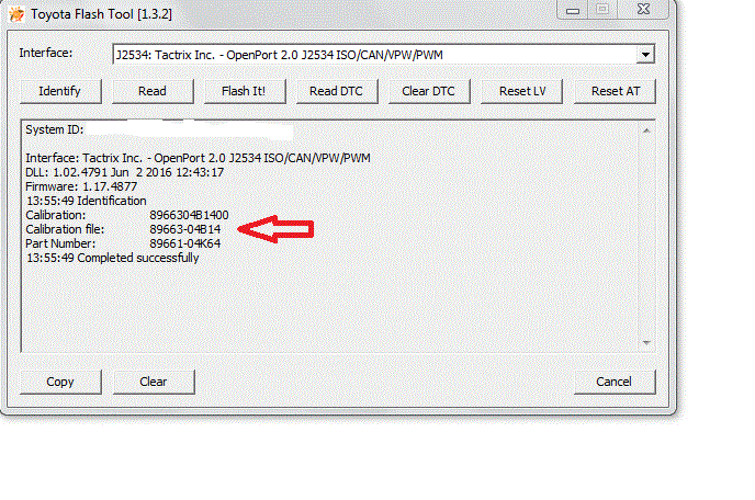

    Hi all. I'm late to the game on this thread. I had purchased and used the old flash manager -- last tune I flashed was the 1.05 back in October of 19..... I've been mostly happy but decided to re gear the truck and am dropping in 4.88s on Monday because I live in the mountains and despite the tune the truck keeps down shifting horribly on hills. I haven't been paying attention to Matt @ OVTune and see there is a new utility available. My flash manager now also doesn't seem to connect to the old ovtune site to download the 1.05.1 or the 2.0 so I am wondering what my options are. It's been so long since I flashed I forget if there was a gear option... I remember the base, performance and gear lock tunes, but don't recall if there was an option to select the gear ratio yet.... I did send an email to support last week and am waiting to hear back. Any guidance is definitely appreciated!

    Mat has pulled the old .p5f files.
    He's switched over to the new vForest tuning software. https://www.ovtuned.com/ ß download button is @ middle of page.
    Legacy users can upgrade :
    $79.00 upgrade - https://vftuner.com/products/vforest-tuner-for-tacoma-flash-kit-owners?variant=31765448884311 see note below ….
    From Mat 1/23/’21 – “we have a new link. Please email us for it.
    I had no choice but to pull it down because so many people were ordering it who weren't previous customers.”
    Also some good reading : https://www.tacomaworld.com/threads/vf-tuner-installation-guide-faq.695951/ ß Answers a lot of Questions
    c/o @Shellshock
    I hope this helps !
