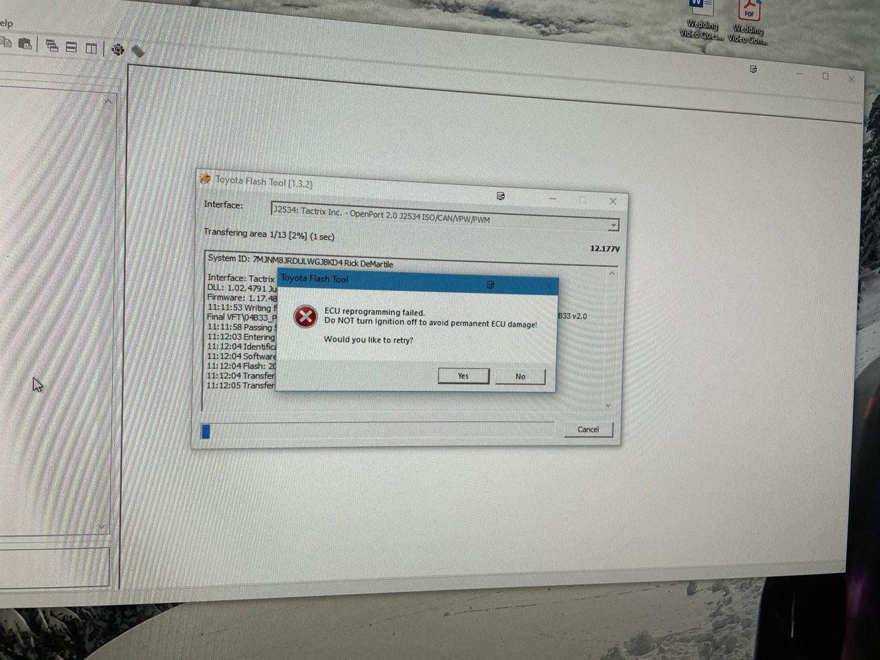

    Need help. Never had issues flashing. Just keep getting this message trying to flash and truck won’t start.

    I’ve had something similar happen a couple times.
    Once i had to reset DTC and try again and it worked
    Another i had to ignition off, ignition on, clear dtc and then it took.

    Reset ignition and clear DTC worked! Thank you! I was freaking out!

    ive had 2 fail on me, it was definitely a pucker moment.
    both were right at the start of the flash like the above picture and didnt screw me up.
    i definitely only flash now when i know i dont have to be somewhere. I was flashing before driving to work...
