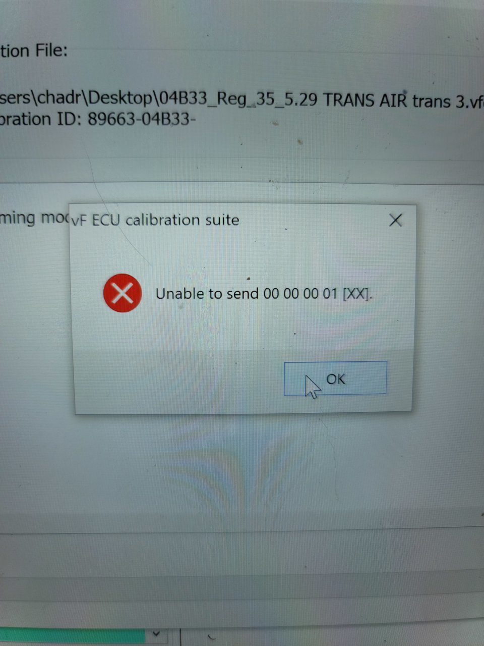

    Just updated. Now getting this error @OVTune
  3. Feb 21, 2021 at 3:52 PM
    #9863
    OVTune
    OVTune Well-Known Member
    Mar 27, 2017
    #214557
    8,112
    OVTune
    99% going to be a connection error, bat voltage, or something interfering.
    the flash process is really straight forward.
    it is very important that you have stable connection, good voltage, and no interruptions.
  4. Feb 21, 2021 at 3:52 PM

    I'm aware that it is straight forward I've flashed plenty of times and know how to read your instructions. It gets 3/4 of the way and gives this error message. Battery voltage 12.325

    OVTune
    Mar 27, 2017
    #214557
    8,112
    OVTune
    okay please zendesk me I will investigate with you 1:1

    Same - downloaded the new version, updated drivers. I've flashed numerous times. Are you 04A61 also. Maybe we're still "special". I'll submit a zendesk ticket.

    OVTune
    Mar 27, 2017
    #214557
    8,112
    OVTune
    it is a verification error msg. The ECU has already flashed by this point.
    Download link has been updated. version did not change.
    - includes driver update (Help > driver installer)
    fix:
    - fixes error message on tacoma 2.0mb ecus.
    - fixes programming progress bar
    - fixes some error messages (clarification on messages)
    OK. All should be good to go.
    if anyone has any errors from this point. Please send us a message - Support@ovtune.zendesk.com
