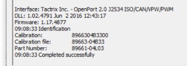

    Hi all,
    Sorry if this seems like a dumb question. I bought VF tuner bundle and the tune pack. I'm trying to follow the new instructions for install, I get to where it prompts us to upload a calibration file, but all I see is stock files.
    How do I see the tunes I paid for?
    When I started doing all this, I was working from the older instructions, I have installed the new VF turner 1.2.9.6
    Any and all help would be appreciated, thanks guys.

    Well, you're on 04B33. That's good.
    Now, you just need to send a message to @OVTune that you want the 04B33 Tune Pack.
  14. Feb 25, 2021 at 11:10 AM

    Don
    2019 voodoo blue TRD PRO
    Yeah, I Just did the TSB update on it right now. Alrighty, yeah. I notice the instructions have changed since I started the process early January. i think i may have missed where it menationed sending him a message for the files.

    No worries. It was always that way to get Tune Packs. Although, it seems that there are a few sets of instructions out there.
