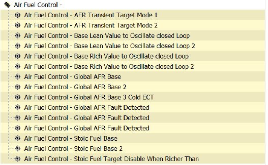

    Just go in and find the 0420 and 0430 tables and turn them off.
    This places the o2 sensors in a not ready status though, which may be an issue for annual inspection, just fyi.
  3. Mar 1, 2021 at 12:03 PM
    Shellshock
    Nov 21, 2015
    #170338
    23,389
    Iowa
    I think those tables are missing in the new vF.. or the name changed again.
  4. Mar 1, 2021 at 12:05 PM
    tonered
    tonered bartheloni
    Sep 25, 2017
    #231055
    31,167
    tony
    Lynnwood, WA
    Name changed. Either in here:
    Or, in here:
  5. Mar 1, 2021 at 12:59 PM

    Sorry! I keep forgetting to look at those when I have a tune file loaded. Those were just from a PDF map list that I made for reference.

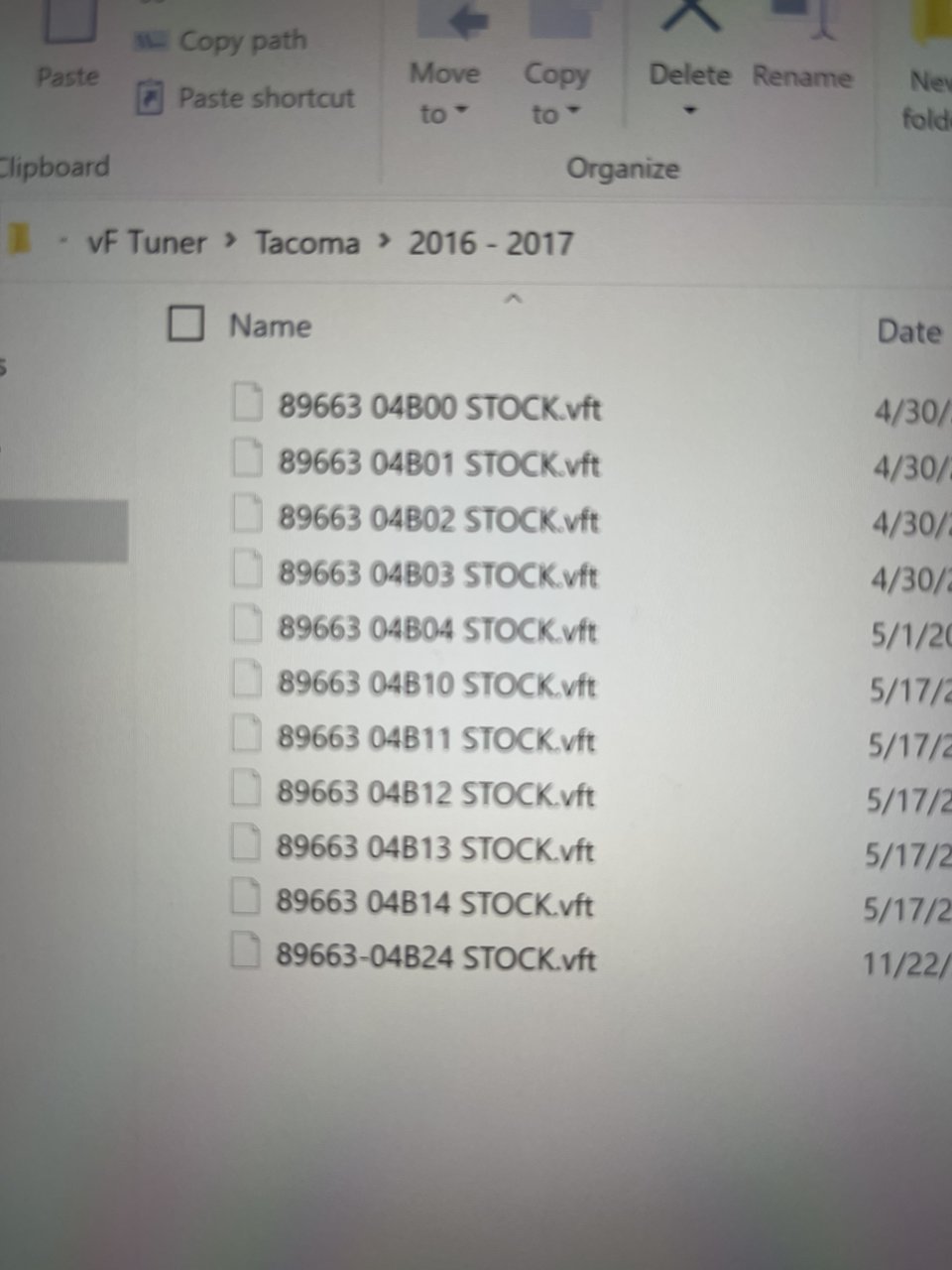

    Speaking of going back to stock flash that was the one thing I did not see how to do in the instructions.
    Is this the file 04B04 ref stock.vtf? Will that get me back to factory settings?
    shotgunbilly420 likes this.
  14. Mar 2, 2021 at 8:51 AM
    tonered
    tonered bartheloni
    Sep 25, 2017
    #231055
    31,167
    tony
    Lynnwood, WA
    Yeah. I spent two tanks on Stock after the last TSB was released. Could barely wait to get tuned again. Trying the Stock hot garbage really resets the perspective.
    ihatemytruck likes this.
  15. Mar 2, 2021 at 8:52 AM
    tonered
    tonered bartheloni
    Sep 25, 2017
    #231055
    31,167
    tony
    Lynnwood, WA
    Yes. The Stock tunes are in the installation folder and will get you back there. The Stock tune is not in the Tune Pack.
