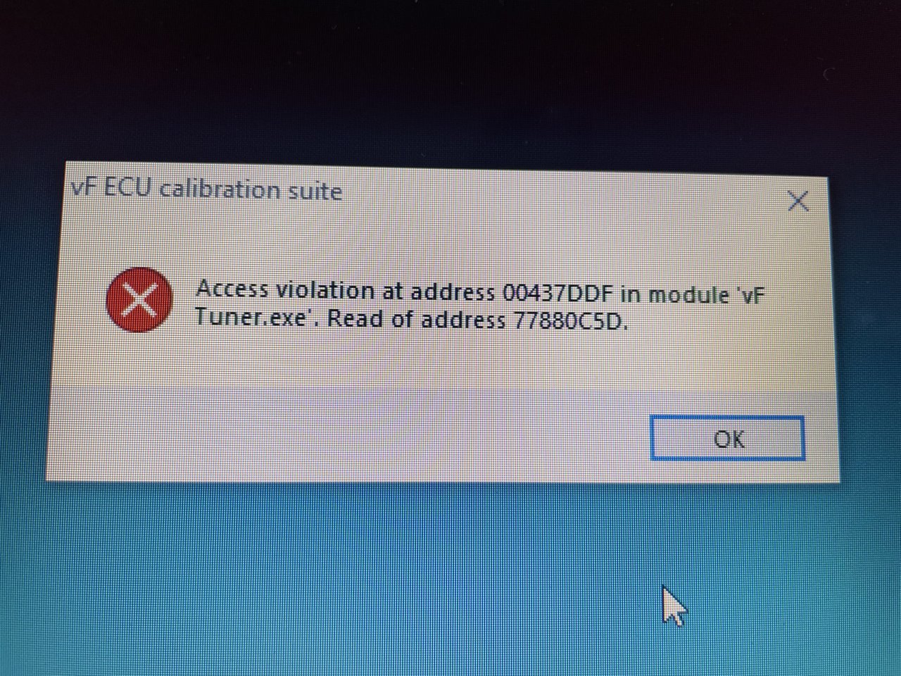

    Downloaded VF tuner and put in my master key and got this. Not good?
    I assume it isn’t a master key issue because that is it the error shown on their instructions that they said indicates a master key issue.
    Also, it says I have 5 credits. Is that correct or should it say 9 at this point?
    For what it's worth, I closed VF Tuner and reloaded it and did NOT get this message a second time. Still not sure what happened/is happening though.

    Assuming the Windows error message that I posted above isn’t an issue, I’m still confused about a few things.
    I got 5 credits when I used the master key on the VF software. When I licensed my truck by plugging it in and hitting the microchip icon and then Prepare ECU, it took 4 of the 5 credits.
    If I try to open the 04C20 base file (calibration?) that is in the folder within VF Tuner, it wants 4 more credits, which I don’t have.
    Beyond that though, do I even need to worry about that if I want to flash an already tuned 04C20 file that I have? Can I just skip the whole calibration file unlock thing that wants 4 more credits and jump right to loading up the tune file I want by clicking the chip icon, then “Prepare ECU”, the “Select Calibration File” (choose the tune file), and then “Calibrate ECM”? Maybe I’m misunderstanding a step.

    I just went through this so I can help a bit. First, only having 5 credits is a bug. I emailed support and they got me another 4.
    Second, I only was asked to unlock my ECU when I opened a tune as well. Everything I’ve seen indicates that you don’t need to unlock an ECU unless you’re going to open and modify a tune. I think this is why several pages back @OVTune said that you can use your 8 credits to flash 2 VINs or you can flash your VIN and unlock your ECU. Someone please correct me if I’m wrong. I didn’t realize this until after I unlocked my ECU. I’ll probably never modify tunes myself so I think I could have kept the extra credits to tune someone else’s truck.

    Did you install the Tactrix drivers?

    yes. The whole first part of licensing the truck and using 4 credits worked fine. Connected great.
