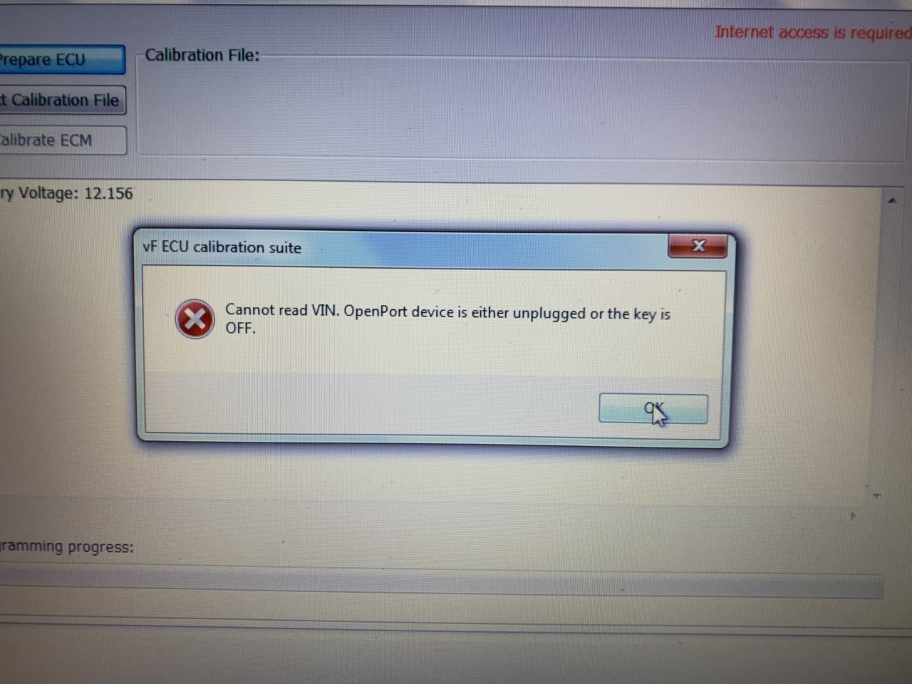

    I’ve got an error. I was trying to install a new tune, I got majority of the way through and got an error. I thought no biggie I’ll turn off the truck and try again but now I’m getting this error. And truck will not start. I’ve restarted the computer, made sure I had the right drivers installed but I’m still getting the same error.

    Do you have internet connection?

    Yup!

    Disconnect the battery, connect the two cables together for 10 minutes. Reconnect, try to flash a stock tune.

    Can you ID your ECU ?
    Try to reset the DTC's ....... then flash again.
    Report results.

    It's acting like my computer isnt connected to the OBD port even though im getting a voltage reading of 12+ and then getting hit with the error.

    Can you swap USB ports and try that?

    Did you update the Tactrix drivers? See the Help menu on the newer vF versions.

    Tried that trick. Didn't work
    Tried that as well, no luck
    That was my first thought as well. Ive updated the drivers and still got nothing.

    @lapoltba and @Shellshock know the procedure better, but there was something about clearing DTCs and trying to flash another tune? Search their recent posts.

    Clearthe DTC using Toyota flash Manager right?

    Send us a zendesk message and include as many details are you can. Including what version you were on.

    That’s what I did for the vF flash tool. I’d assume the same things are still applicable with the new one but I’m not super familiar with it yet

    Ended up clearing the DTC using the old flash manager and flashing using flash manager. Truck is purring like a kitten again. I’m kinda thinking I got a corrupted file and that caused the original tune to fail.
    Thanks for all the help fellas!
