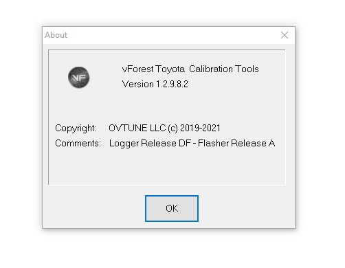

    What version are you on. The Scion tCs are having flash issues and OVT is trying different Flash Tools to fix it.
    Version 1.2.9.8.2 was posted today.

    Yup that one 1.2.9.8.2. Just strange that techstream works fine with the ECU. I do have a stable internet connection if that's any help.

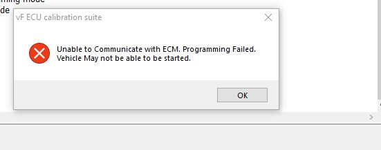

    I cannot get my ECU flashed. I've read this thread and saw same problems, but those solutions did not fix it... unless I'm missing one. Picture shows the issue.

    Yikes! You're sticking with 04B00?
    Otherwise, there seems to be some flashing issues with the last couple vF versions. @OVTune is trying to discover the problem.

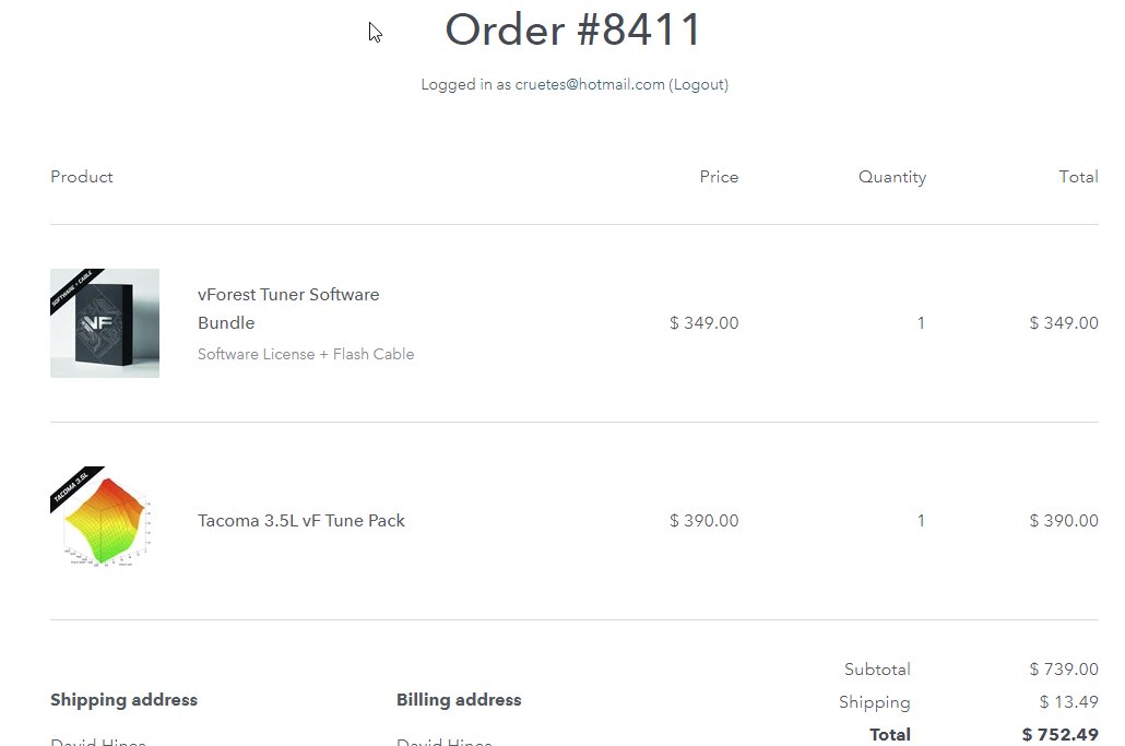

    No, I was testing all of them! I am also waiting on my flash packaged that I purchased.

    You cannot test flash without the kit. You need the vF / Tactrix adapter to be connected on both ends.
    You also cannot flash a vF Tune to a different ECU ID than is on your Taco.

    I have the kit, calling the other one the wrong name... Tune Package I am waiting on.

    Ah! You have to message OVT to get the ECU ID that you want for the Tune Pack. Be sure that you are one the most current TSB, 04B04. But, I do expect a new TSB to come out for the 2016 through 2018 ATs at any time.
    I think that confirms the Flash Tool issue. If you can find any Version 1.2.9.6 or older, that should fix your issue. Version 1.2.9.8 and Version 1.2.9.8.2 seem to have the problem?
