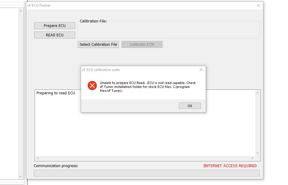

  5. Mar 20, 2021 at 6:29 PM
    SpeySquatch
    SpeySquatch Function over Form
    Mar 6, 2018
    #246516
    7,365
    2016 TRD OR DCSB
    C4Fab LoPro, BAMF Sliders, Ext ADS 2.5’s, 4.88's, OVTune (OG to KDMax)
    did the latest update. Did anyone else have this problem? I haven't until now
    internet is good. seems like a program file error is happening. Already re-installed, with same fail. @OVTune
  6. Mar 20, 2021 at 6:31 PM
    lapoltba
    lapoltba Full Bridge Rectifier
    Aug 28, 2014
    #137089
    3,346
    CT - 06076
    '17 Sport, ACLB, V6,MT, 04B14 OV-Tuned
    If you're trying to read, you cant.
    Tac0Tic0 and Shellshock like this.
  7. Mar 20, 2021 at 6:33 PM
    SpeySquatch
    Mar 6, 2018
    #246516
    7,365
    2016 TRD OR DCSB
    yes, was trying to prepare the ECU so I could try a new tune on the new download.
    Am i missing something?
  8. Mar 20, 2021 at 6:35 PM
    lapoltba
    Aug 28, 2014
    #137089
    3,346
    CT - 06076
    Did you click "prepare ECU" or "Read ECU"? You can't read the ECU after you have flashed a tune.
  9. Mar 20, 2021 at 6:37 PM
    wiljayhi
    wiljayhi “..ain’t nobody’s business if I do…”
    Oct 8, 2018
    #268685
    2,635
    Jim
    Murky Water, MB, eh?
    3G, Tuned
    Need internet connection to prepare ECU. You connected?
  10. Mar 20, 2021 at 6:37 PM
    SpeySquatch
    Mar 6, 2018
    #246516
    7,365
    2016 TRD OR DCSB
    Tried both, "prepare" first
  11. Mar 20, 2021 at 6:37 PM
    SpeySquatch
    Mar 6, 2018
    #246516
    7,365
    2016 TRD OR DCSB
    you didn't read what i posted
  12. Mar 20, 2021 at 6:38 PM
    lapoltba
    Aug 28, 2014
    #137089
    3,346
    CT - 06076
    Don't click "read ECU". You need to be online to prepare. It will contact the server and if you haven't already unlocked your VIN, it will request you to use credits to do so.
  13. Mar 20, 2021 at 6:40 PM
    SpeySquatch
    Mar 6, 2018
    #246516
    7,365
    2016 TRD OR DCSB
    I used creds with the previous download. Is this new? I haven't had an issue until this download
  14. Mar 20, 2021 at 6:41 PM
    lapoltba
    Aug 28, 2014
    #137089
    3,346
    CT - 06076
    Ok, so you get that message when you click "prepare ECU"?
    If prepare works all you have to do is "select calibration file" and then "calibrate ECM". You don't need to click the "read ECU" button.
  15. Mar 20, 2021 at 6:47 PM
    SpeySquatch
    Mar 6, 2018
    #246516
    7,365
    2016 TRD OR DCSB
    What calibration file do I choose. That is the part I don't understand, have never done.
    That is new to me
  16. Mar 20, 2021 at 6:48 PM
    lapoltba
    Aug 28, 2014
    #137089
    3,346
    CT - 06076
    Whatever .VFT file from the tune pack or other source that you want to put on your truck. That part is exactly the same as every other VFTuner version although button labels may be slightly different.
  17. Mar 20, 2021 at 6:49 PM
    SpeySquatch
    Mar 6, 2018
    #246516
    7,365
    2016 TRD OR DCSB
    Wait, so it flashes after you prepare the ECU? I have never done that
    Did the interface process change?
  18. Mar 20, 2021 at 6:50 PM
    lapoltba
    Aug 28, 2014
    #137089
    3,346
    CT - 06076
    Right... That's part of the whole new licensing scheme where it's 4 credits per VIN flashed. You should have gotten 4 credits to use for unlocking your VIN. If you already did that you're good to go. Just pick a file and flash.
  19. Mar 20, 2021 at 6:51 PM
    SpeySquatch
    Mar 6, 2018
    #246516
    7,365
    2016 TRD OR DCSB
    4 creds with the new download, correct?
  20. Mar 20, 2021 at 6:54 PM
    lapoltba
    Aug 28, 2014
    #137089
    3,346
    CT - 06076
    It happened a while ago (maybe a couple weeks?) everyone just got 4 extra credits. I don't know if you would have gotten them if you were on a version prior to the new licensing though, Mat would have to answer that. At some point though, you should have gotten a message that said something about having 4 credits delivered. You can verify in VF Tuner by going to Help>license information. It will show available credits. You should have at least 1 there (VFT license) if you already registered your VIN. If you didn't you will probably have 5.
