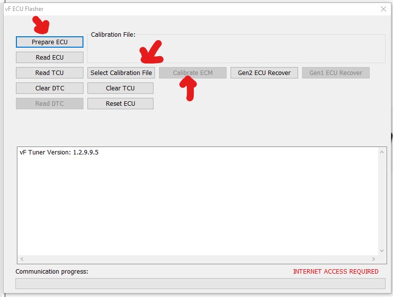

    I don't need to view a new ECU before I flash it?
  11. Apr 5, 2021 at 10:21 AM
    tonered
    tonered bartheloni
    Sep 25, 2017
    #231055
    31,242
    tony
    Lynnwood, WA
    Nope.
    Just launch the Flash Tool, Prepare the ECU (Unlock the VIN), Select the Tune File, and Calibrate the ECU. You can choose to do the DTC, LV, and AT (if applicable) Resets, if you would like.

    not turning power management off on the USB port could do it to right?
  17. Apr 5, 2021 at 7:15 PM
    tonered
    tonered bartheloni
    Sep 25, 2017
    #231055
    31,242
    tony
    Lynnwood, WA
    I don't know. All this time, I've been like:
    :anonymous: Do not use hacked versions of TechStream for an ECU update.
    :thumbsup: Do not use a virtual machine environment to do an ECU update.
    :thumbsup: Do not use Bluetooth or WiFi dongles for an ECU update (USB only).
    The Tactrix is a proven option. Other USB adapters (cheap chinesium ones) are not proven. A few folks have bricked their ECUs using them.
    :anonymous: Turn off Windows Update service.
    :anonymous: Turn off Windows system sleep functionality.
    Use the “always on” setting in power management pane.
    :anonymous:
    Turn off USB Power Management for the USB port you are using.
    :anonymous: Plug the laptop into a wall outlet.
    :thumbsup: Set the computer on the seat and do not touch it while it flashes! A bump or loose USB port could be a bad day.
    :anonymous: Hook up a battery maintainer to the vehicle during an ECU update.
    :anonymous: / :thumbsup: Turn off all electrical consumers during ECU update.
    :anonymous: Open the hood.
    codemancer, ktbell444, Phich and 4 others like this.

    What is this for? ^^^
  20. Apr 5, 2021 at 7:39 PM
    SubaruTheTacoma
    SubaruTheTacoma SubaruTheTacoma
    Mar 1, 2019
    #284929
    468
    Rhys
    USA
    2017 STI Off Road
    HELLA Horns BP-51 ARB Summit SCS Ray 10 And many many others
    What you should do when you update / mess with your ecu
    tonered likes this.
