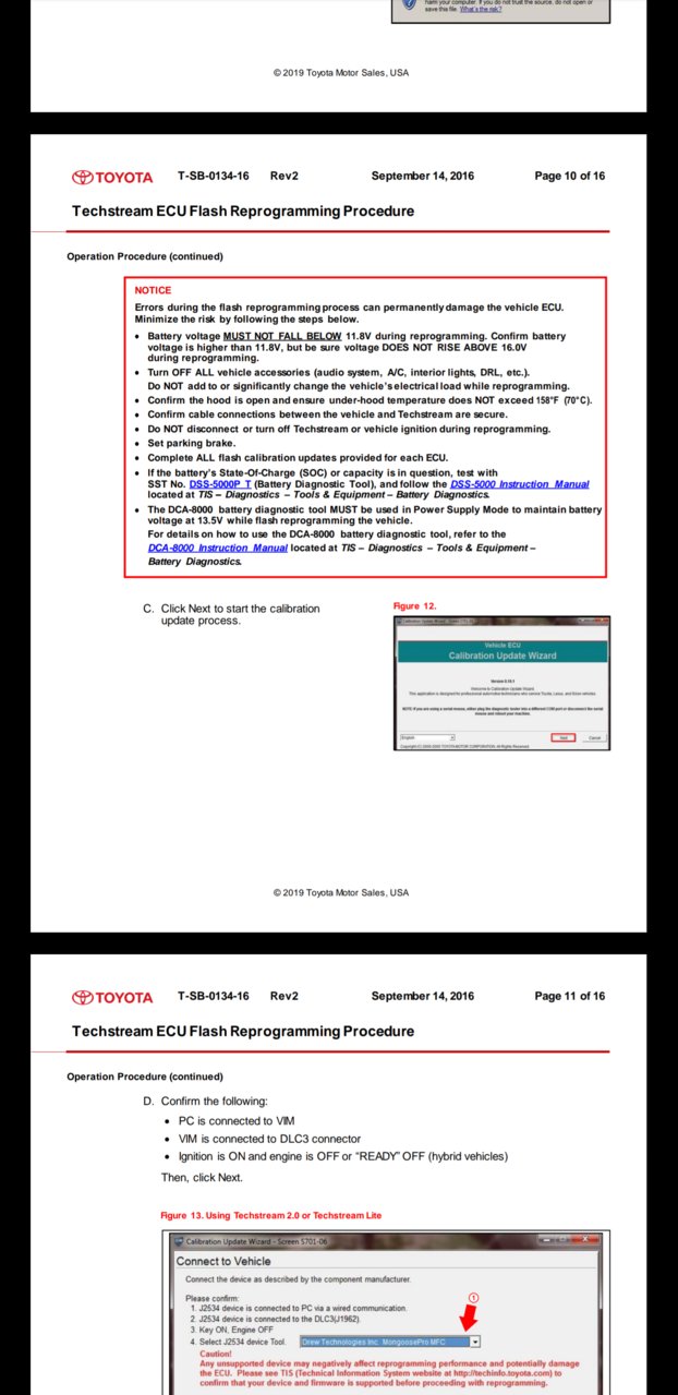

    It is in the Toyota flashing TSB attached to the 1st Post of the thread.
    But, flashes will halt if the engine bay temp exceeds either 158F or 168F. Can't remember exactly.

    I’m still confused where the open the hood came from
    probably the same guy that started the idle for 30 minute recommendation

    It is in the flashing TSB. See the notice box:

    Weird. Never opened the hood.

    Weird
    guess I didn’t read the instructions lol

    I don't even turn off the radio :oops:

    I honestly just turn down the radio at most, I don't worry much. Yeah yeah, I'm a monster.

    If you don’t open the hood how do you attach a battery tender ?o_O

    The battery whater.
    The stock Tacoma battery is so good. It doesn’t need a tender.
