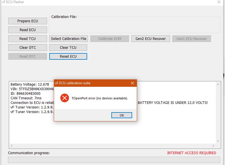

    Got this when trying to Reset ECU after the flash. is this normal?

  7. Apr 6, 2021 at 6:43 PM
    tonered
    tonered bartheloni
    Sep 25, 2017
    #231055
    31,247
    tony
    Lynnwood, WA
    Yeah. I got that today.
    No idea.
  8. Apr 6, 2021 at 7:32 PM
    mZiggy
    mZiggy Honey badger
    Apr 8, 2017
    #215707
    4,709
    Marc
    2020 MGM Tundra SR5; 2020 4R TRD Pro; 2008 4R SR5 v8
    Yesterday when attempting ecu recovery on somebody, I got this. Basically when recovery failed or even just hitting prepare ecu for shits and giggles failed, everytime after that for any button, it would give that error until the flash tool was closed and reopened. Then it would let me try something without immediately giving the error.
    But once it had identified that there was no communication with the ecu, that's what I got every time until closing and reopening. That error, or one similar to it that said the truck was either off or communication unavailable or something along those lines
  9. Apr 6, 2021 at 7:34 PM
    lapoltba
    lapoltba Full Bridge Rectifier
    Aug 28, 2014
    #137089
    3,346
    CT - 06076
    '17 Sport, ACLB, V6,MT, 04B14 OV-Tuned
    Yeah, I assmume that is what is going to happen when it's too far gone to be saveable by software alone. I'll be getting that one shortly and will do some bench flash testing when I recover it.
    mZiggy[QUOTED] likes this.
  10. Apr 6, 2021 at 7:41 PM
    Unlawful_moose
    Unlawful_moose Active Member
    Jan 26, 2020
    #317347
    25
    Ontario, Canada
    2019 DCLB Sport Super White
    Ovtune 2.0, Bilstein 5100's, Clazzio covers!
    Yea, that wasn't the first prompt that i got either. First one said something along the lines of 'no ecu to reset found.Engine off?'. Tried re-opening application and it would only give me the openport error after, even when prep ECU command was able to verify connection with ECU

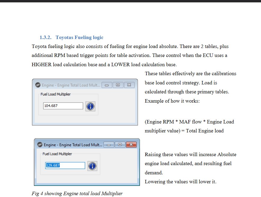

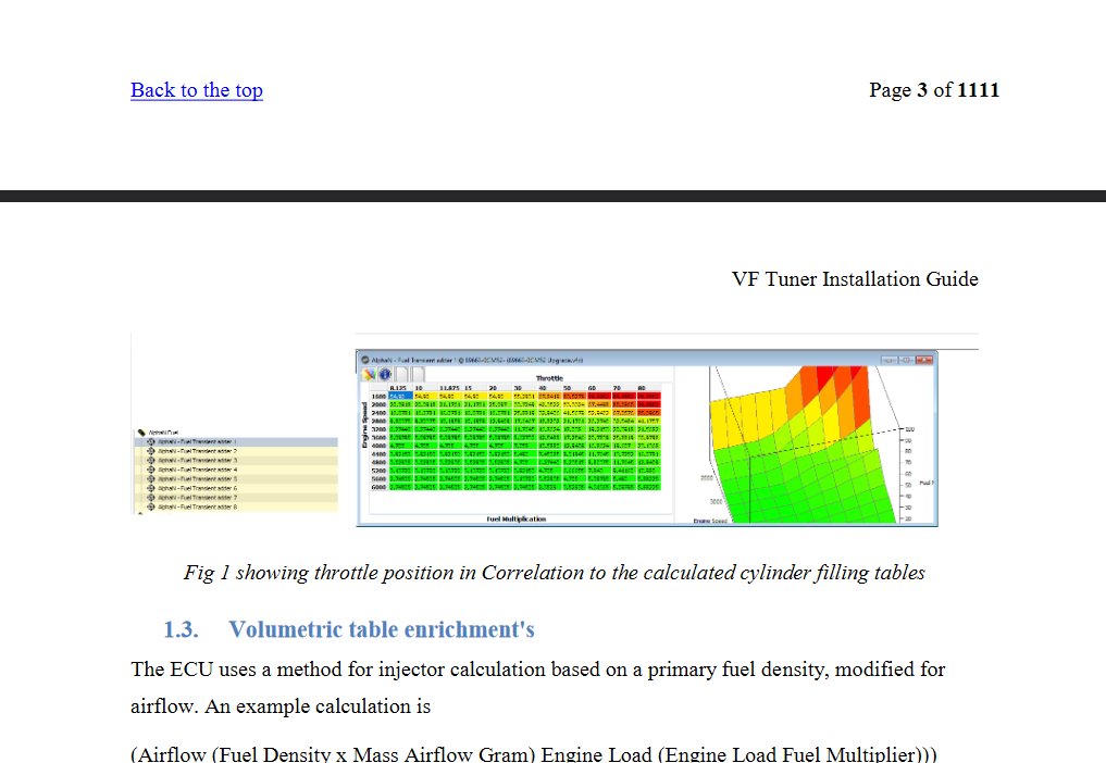

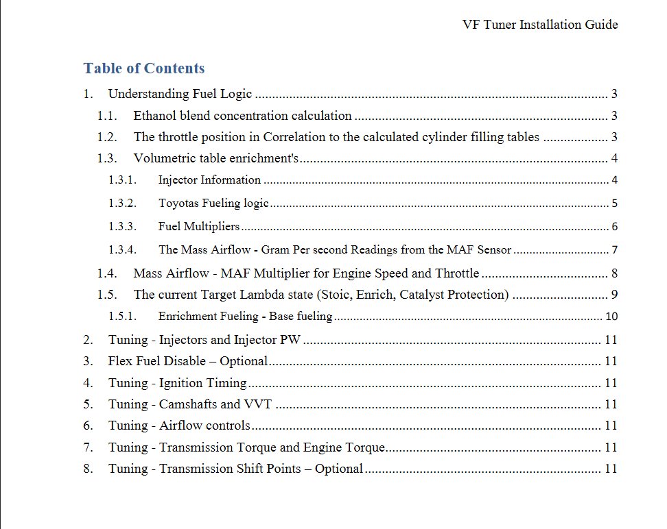

  13. Apr 7, 2021 at 10:06 AM
    OVTune
    OVTune Well-Known Member
    Mar 27, 2017
    #214557
    8,112
    OVTune
    coming soon to a tuner near you
    FULL IN DEPTH GUIDES
    wahoobie, inksin, Mr. Nobody and 19 others like this.

  19. Apr 7, 2021 at 11:50 AM
    MOC221_
    MOC221_ 3 pedal metal
    Feb 20, 2016
    #178858
    7,850
    Frank
    2019 DCSB Sport M/T Barcelona Red
    vF Tuned; ADM; Core SS
    Wait.. I'm finally gonna know what these tables I'm fucking with ACTUALLY do??
    Get the fuck outa here :D
  20. Apr 7, 2021 at 12:22 PM
    CAG Gonzo
    CAG Gonzo Ascendant Spaghetti
    Oct 25, 2018
    #270558
    1,688
    2018 OR DCLB BarRed
    Is that guide for pro tuners or everyone?
    C41n likes this.
