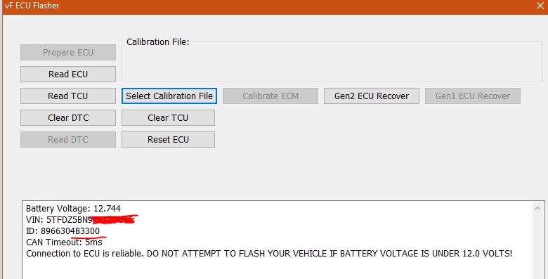

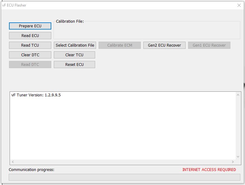

  2. Apr 7, 2021 at 1:32 PM
    Prowlah
    Prowlah Well-Known Member
    Apr 3, 2018
    #249268
    256
    SoCal
    2017 Silver DCSB TRD Sport 4x4
    Which button did you click to display your ID?

    Hit the 'Prepare ECU' button, if you've never flashed anything before it may ask you to unlock your VIN which should be 4 credits (i think)

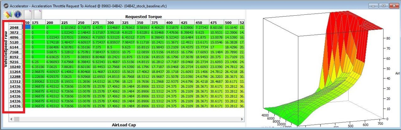

    @OVTune , ref this map:
    Have you got real world km/h or mph values for the vehicle speed raw axis?
    I've been looking through the SM and have found a reference that states the speed pulse signal coming from the skid control ECU is 4 pulses per rotation of a wheel. Even when calculating using wheel RPM based on veh speed (using the proper tire size), these map axis values don't line up. I even tried using voltage transitions instead of "pulses".. lol still nogo.
    Edit: Well, the pattern of increase is predictable at least.. 1024 "units" per cell. Smells like digital shyte. Bits per hour lol?

    divide values / 128.
    I'll make sure to update the def to do this

    im assuming that would go to KMH
    so this roughly equates to 5 MPH per cell, starting at 10mph for the lowest value.
    2048 16kph 10mph
    3072 24kph 15mph
    4096 32kph 20mph
    5120 40kph 25mph
    6144 48kph 30mph
    7168 56kph 35mph
    8192 64kph 40mph
    9216 72kph 45mph
    10240 80kph 50mph
    11264 88kph 55mph
    12288 96kph 60mph
    13312 104kph 65mph
    14336 112kph 70mph

    Hmm, although 112mph is just above the stock global speed limiter..
  15. Apr 10, 2021 at 12:38 PM
    92ehatch
    92ehatch Well-Known Member
    Jun 9, 2019
    #295818
    841
    Kinley
    Hendersonville NC
    2019 Cavalry Blue DC TRD OR 6MT
    re-read it.
    it stops around 70 mph
    MOC221_[QUOTED] likes this.

    Unless you assume the value you start with is mph and not kmh..
  18. Apr 10, 2021 at 12:42 PM
    92ehatch
    Jun 9, 2019
    #295818
    841
    Kinley
    Hendersonville NC
    i just figured since everything else is in nM and KPH it would make more sense to go the other way. But you are correct, we are just assuming

    Understood, awaiting @OVTune answer!
    Is it km/hr or mph?
