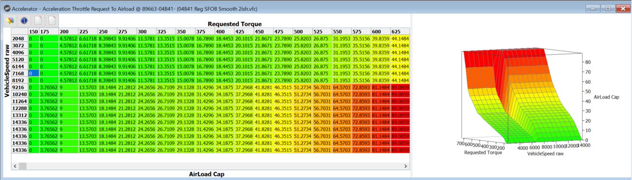

    @MOC221_ I didnt screen shot the first attempt, but did the second.
    So i did this, at 35 "mph" (blue highlight marks first attempt) and again at 45 "mph" (current map). I did not get any noticeable change/jump when crossing the speeds if calculated in KPH.
    Its raining, so i couldn't go above 45 or 50 on my roads in the conditions. If these are in MPH then i would have to be traveling between 56 (first attempt) and 75 (second attempt) to notice the effects, which i never hit in either drive.

    @MOC221_
    On 04A61 I am certain that the shift schedule maps are in mph, and I am pretty sure that the transmission throttle reduction maps are also in mph. I have nearly the same axes for this map in 04A61. I would bet it's in mph. Running 92ehatch's test and verifying a throttle bump would prove it, though.

    im gonna try it again, lower in the range to try and capture around 30 - 40 mph. possibly with more bump.
    everyone likes more bump
