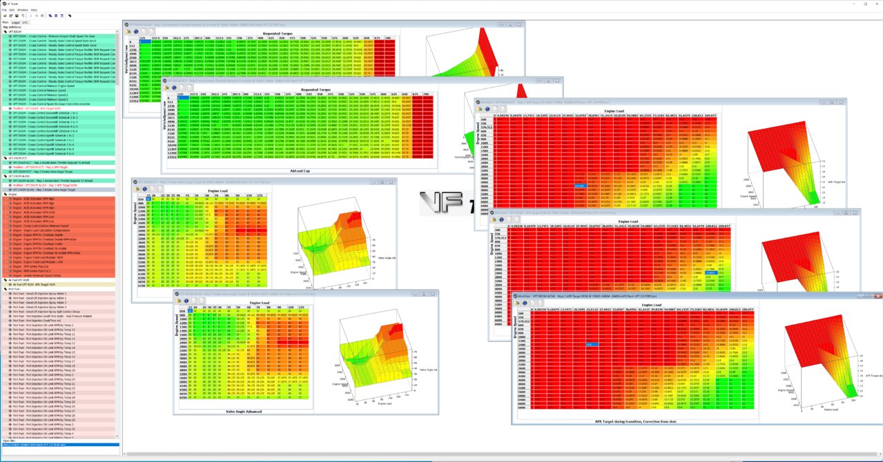

    VF TUNER -
    Pro Tuners are eligible to request Beta access
    - starting with ECU ID 04B04 -
    3 Way Map switching + AFR Target Control tables.
    For their own development / testing and tuning.
    Parameters
    - AFR Target control (standard)
    - AFR Target control ( ECT ON)
    - AFR Target control ( 4LOW)
    - Intake Valve timing (standard)
    - Intake Valve timing ( ECT ON)
    - Intake Valve timing ( 4LOW ON)
    - Throttle control ( standard)
    - Throttle control (ECT ON)
    - Throttle control ( 4LOW ON)
    Transmission -
    - Single Shift map patch -
    - All standard shifting controlled through 1 set of shift tables
    - All ECT Based controls through 1 set of shift tables
    -Elimination of individual tables for cold ECT
    Message us for more details
    PRO TUNERS ONLY AT THIS TIME.

    Can anyone elaborate on what "AFR Target Control" is?

    If I'm understanding how systems like HP Tuners' interface and other software works, I think it's a means of telling the truck what AFR to actually use.
    For example, vehicle is on the dyno and you're trying to bump up power in a specific rpm range, let's say 3000-3500rpm, at 75% throttle. Set a target AFR and then watch your power curve. Edit as needed, rinse and repeat.
    If I'm understanding correctly from videos I've watched about the tuning process WRT editing AFR

    So this table would be a one stop adjustment to change target AFR based on rpm & load instead of having to find all of the tables that input for AFR based on various conditions, etc? If so, that would be pretty damn slick assuming it works that way without compromise.

    Would be very cool indeed. Mat would need to confirm that's how it'll work however. I could be way off

    Yes that's how it works. Use that 1 map to target the AFR you want and ignore all the other tables.

    How will this handle CL/OL behavior? Any change to that or will it just adjust the CL AND OL AFR values/tables without changing the switching logic to hit the targets in the new table?

    This is our full time CL AFR target patch. Once the truck enters CL (from start up) this map takes over.
    Really simplifies AFR tuning.

    Nice. So this would make it so it never enters OL mode?
