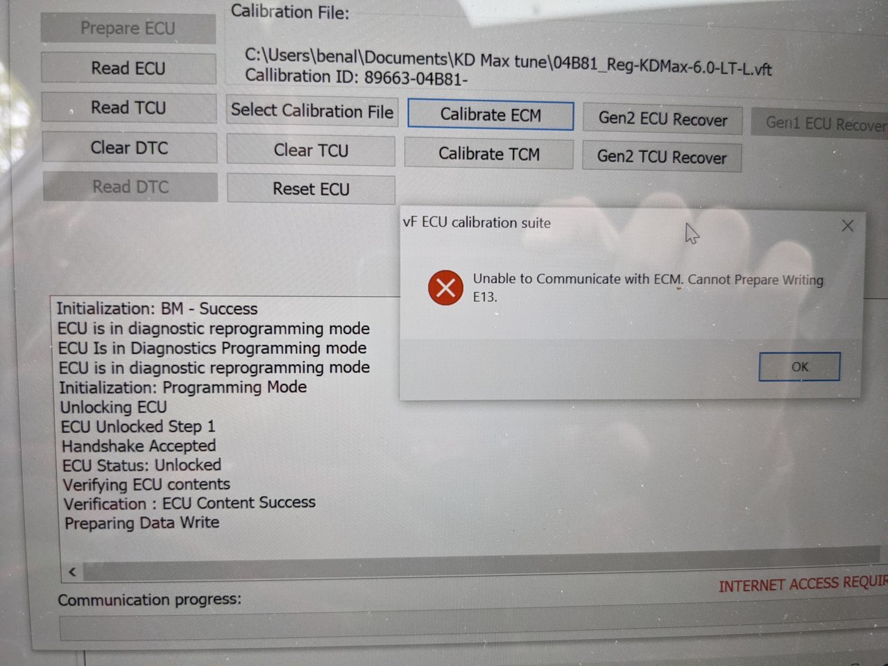

    I just purchased VFTune Package. I received the key in email. I licensed the software and then the VIN after it came back online. I was trying to view my stock calibration to see the maps to start editing. The directions stated reading the ECU, saving to be able to open and edit.

    OK If I go to open file from the main menu, select 04b04, it is asking me for more credits. I received 5 after registering, used 4 for licensing VIN. I thought it came with the ability to edit my stock calibration 04b04.

    Reply to your order email and let Matt know you only got five. Should come with nine. Once you get them you will be able to edit it.

    Matt I'm receiving the same message. Unable to prepare ecu read. I've unlocked the Vin already and need to confirm ecu id before Calibration.

    You Dont need to read your ECU if you have a tune pack and just want to flash a file...

    I need to confirm that the ecu is current before I flash. It's not my truck.

    Tacoma build stuff Kings all around with adjustable reservoirs SKU: KIN25001-119A-EXT KIN25001-121A-EXT Pakrax sliders https://pakrax.com/products/pakrax-16-current-tacoma-sliders Pakrax tailgate panel https://pakrax.com/collections/toyota-tacoma/products/pakrax-05-current-tacoma-tailgate-panel?variant=30310492569705 Body armor pro series front bumper https://www.bodyarmor4x4.com/product/toyota-tacoma-pro-series-front-bumper/ Westcott roof rack https://westcottdesigns.net/product/toyota-tacoma-3rd-gen-modular-roof-rack/ SPC UCAs https://www.4wheelparts.com/p/specialty-products-upper-control-arm-set-25470/_/R-FCMW-25470 Ironman 4x4 full skids https://ironman4x4america.com/heavy-duty-skid-plate-kit-suited-for-2005-toyota-tacoma/ Rough country 30” light bar w/DRLs https://www.roughcountry.com/30-inch-led-light-bar-70930blkdrl.html Rigid fogs https://www.rigidindustries.com/d-series-pro-spot-surface-mount-black-2-lights-202213.html Voswitch 8-button switch panel https://m.voswitch.com/UV100-Universal-8-Gang-Programmable-Switch-Panel-for-Truck-UTV-Side-by-Side-Boat-p1291994.html Gatorfx tri-fold tonneau https://gatorcovers.com/p/gator-fx-tonneau-cover/v/toyota/tacoma/2020/ Anytime backup and front cam https://www.anytimebackupcamera.com/products/2020-kit 3TPAM powered dash mount https://expeditionessentials.com/collections/frontpage/products/toyota-tacoma-3rd-gen-usb-powered-accessory-mount Fieryred 13k synthetic winch https://fieryred.com/collections/winch/products/12v-13000lbs-synthetic-rope-winch-kit Meso Customs stealth pro 2-button shift knob https://mesocustoms.com/collections/toyota-tacoma-3rd-gen/products/stealth-pro-shift-knob?variant=21433407438961 Meso/Morimoto collab Ultimate Tail Lights https://mesocustoms.com/collections/toyota-tacoma-3rd-gen/products/ultimate-tacoma-tail-lights-full-led AJT key fob https://www.ajtdesign-llc.com/online-store/V1-Fob-Case-c69661004 Victory 4x4 center console molle panels https://www.victory4x4.com/product/VTCC.html Desert Does It Seat Jackers https://desertdoesit.com/collections/toyota/products/2005-2019-toyota-tacoma-1-1-4-front-seat-spacer-lifts-front-of-seat + multi mount panel on passenger seat https://desertdoesit.com/collections/toyota/products/front-multi-mount-panel RXT leaf pack https://iconvehicledynamics.com/accessory/15947/icon-accessories-05-up-tacoma-multi-rate-rxt-leaf-pack-w--add-in-leaf/ Redline hood quicklift elite https://www.redlinetuning.com/2016-Toyota-Tacoma-Hood-QuickLIFT-ELITE-p/21-27015-03.htm Hypertech speedometer calibrator https://hypertech-inc.myshopify.com/pages/product-result?rq=yr_2020~mk_toyota~md_tacoma~wa_3-5l-v6-gas Kicker speakers all around https://www.crutchfield.com/p_20646CC674/Kicker-46CSC674.html https://www.crutchfield.com/p_20646CC693/Kicker-46CSC6934.html Kicker Key 500.1 https://www.crutchfield.com/p_20647KEY50/Kicker-47KEY500-1.html Wireless CarPlay adapter https://cplay2air.com/ Duro bumps front and rear https://durobumps.com/product/3rd-gen-toyota-tacoma-front-bump-stops/ https://durobumps.com/product/3rd-gen-tacoma-rear-bump-stops-3-5-2016/ K&N CAI https://www.knfilters.com/63-9039-performance-air-intake-system 285/75/17 Falken wildpeaks a/t3w https://www.discounttire.com/buy-tires/falken-wildpeak-a-t3w/p/26812 KMC Grenade 17x9 -12mm offset wheels https://www.kmcwheels.com/kmc-grenade-off-road AVS bugflector 2 hood shield https://www.autoventshade.com/bugflector-ii/2020/toyota/tacoma AVS low-profile window visors https://www.autoventshade.com/low-profile-color-match-ventvisor/2020/toyota/tacoma Cheap+effective Amazon front&rear dash cam https://www.amazon.com/dp/B08M9JD55C/ref=cm_sw_r_cp_api_i_5K49S7WFCC5XMAPDDY3E Tailgate lock https://www.amazon.com/dp/B07ZL2WCLD/ref=cm_sw_r_cp_api_i_KYY3FYH3ZS06DYZVDAHT Fumoto valve(easier oil changes) https://www.amazon.com/dp/B085RBL4KW/ref=cm_sw_r_cp_api_i_GPBZJTJ0NTAA85R3G2DY?_encoding=UTF8&psc=1 K&N Premium Oil Filter https://www.amazon.com/dp/B0067ED49C/ref=cm_sw_r_cp_api_i_D5DHE5F27G5CW8HHCC31?_encoding=UTF8&psc=1 Raptor-lined fender flares and rocker panels https://www.amazon.com/dp/B07DGVMWS9/ref=cm_sw_r_cp_api_i_KQXFHYDEVNH49SKTA9P4?_encoding=UTF8&psc=1 Supreme Suspensions D-Ring Shackles https://www.amazon.com/dp/B082PDV9KR/ref=cm_sw_r_cp_api_i_EGX04F00SXJ6MBMCR3NW Heritage grill with lights CMC Arizona Toy Pros Needle bearing -> bushing swap Arizona Toy Pros OTT tune with Mild>Medium throttle by Eddie Erosa/AZC Edge/me!
    You can still do that using "prepare ECU'. I usually have to connect my phone for a hotspot when I tune people, so I just don't connect it until I've done that first. There'll be a popup saying "not connected to server" or something, but you don't really need to be until you actually hit "calibrate ECU". If the "license VIN" choice pops up, just ignore it and look past the box to see your voltage and ECU ID. Nobody has any real reason to use the feature of "Read ECU" except someone with a unique ECU ID or someone trying to diagnose their already-flashed tune.

    It's not showing the Calibration file when I prepare ecu. The read ecu has always worked for me unless it's something new that it doesn't do what it says now.

    You're on the newest VF, right?

    Yes sir. Updated yesterday.

    Also had the Hotspot running the whole time.

    And here's what I've got now.
