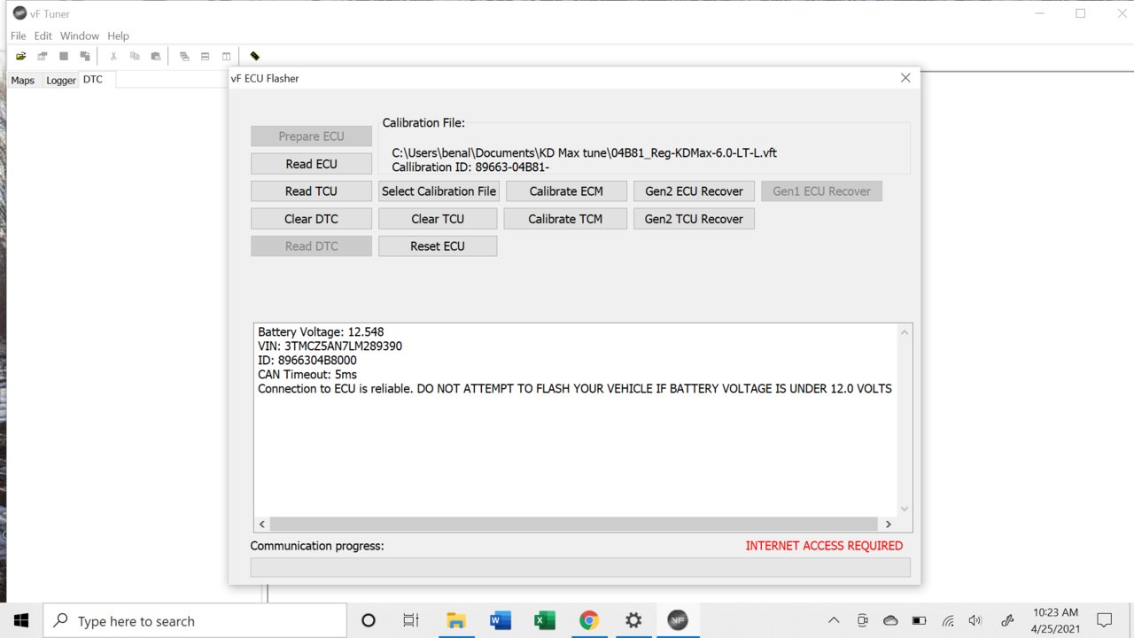

  2. Apr 25, 2021 at 9:26 AM
    OVTune
    OVTune Well-Known Member
    Mar 27, 2017
    #214557
    8,112
    OVTune
    Contact the person you got the file from and request the proper file.

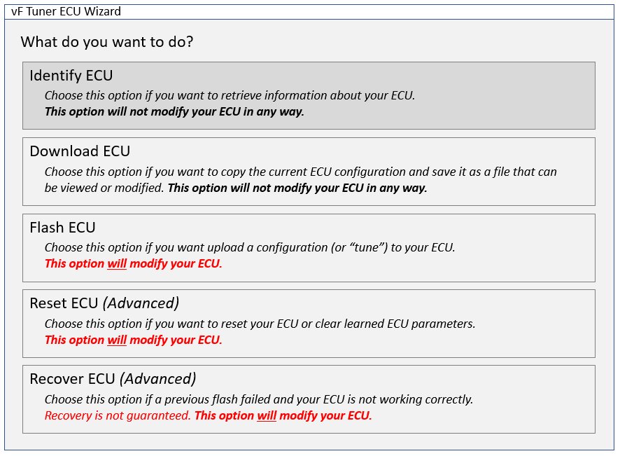

  3. Apr 25, 2021 at 9:29 AM
    PapaRee
    PapaRee Pro Tuner
    Oct 31, 2015
    #168275
    3,250
    Kreg
    Prairieville, Louisiana
    2016 Black TRD Sport, Tuned, BHLM OEM LEDs
    GTS Dobinson's lift, 33"-Wildpeak Atw3-18x9 -6 Offset ,265/70/18 tires, Raceline Assault wheels, Backflip G2 bed cover, Magnaflow exhaust, Pro tail lights, Pro fog lights, Pro grille, Raptor grille lights, Predator side steps, RedLine Hood Struts, Toyota bedmat, tinted windows, Retrofitted-BHLM-Amber Halo-Amber DRL-HID headlights, LED Highbeams, LED Hood Scoop lightbar, LED hidden bumper lightbar, LED under hood light, LED Bed lights, LED license plate lights, Tacoma tailgate 3d letters, Tacoma glovebox 3D letters, removed air dam, Custom TRD Sport emblems, Pro Shift Knob with Meso ECT Stealth button, Meso LED dome and map lights, Meso V3 smoked mirror turn signals, Meso Stage 2 Tail lights, Meso Mirror Puddle lights, Meso KC-5 Brake/Cargo light, Meso center console bucket with OG lid, Tailgate PNP kit, Garage door opener button in overhead console, Meso Minimalist keyfobs, Matte black Pro hood decal, KTJO4x4 Led door handle LED lights, Pioneer 6x9 3 way front speakers, Rockford Fosgate 6.75' rear speakers, TacoTunes tweeters, AJT black vent rings, JDM Gas cap cover.
    I am PMing with him.
    I told him just like everyone else, he needs to update his ECU.
    He is getting it done.
    I am now asking people for their ECU ID and making sure that they are updating.
    Everyone seem to want to "read ECU", I miss the "Identify" button.
  4. Apr 25, 2021 at 9:38 AM
    OVTune
    Mar 27, 2017
    #214557
    8,112
    OVTune
    with how many people you are providing services and files for you should consider creating an instructions set. There is no Identify button on the new software

  6. Apr 25, 2021 at 9:47 AM
    PapaRee
    PapaRee Pro Tuner
    Oct 31, 2015
    #168275
    3,250
    Kreg
    Will do.
    I point them to your instructions for Vftuner.
    The problem is that there are so many new people. The old software was much simpler and user friendly. That Identify button helped people figure out the ECU version.
    Maybe if the Prepare ECU button was Prepare/Identify ECU.
