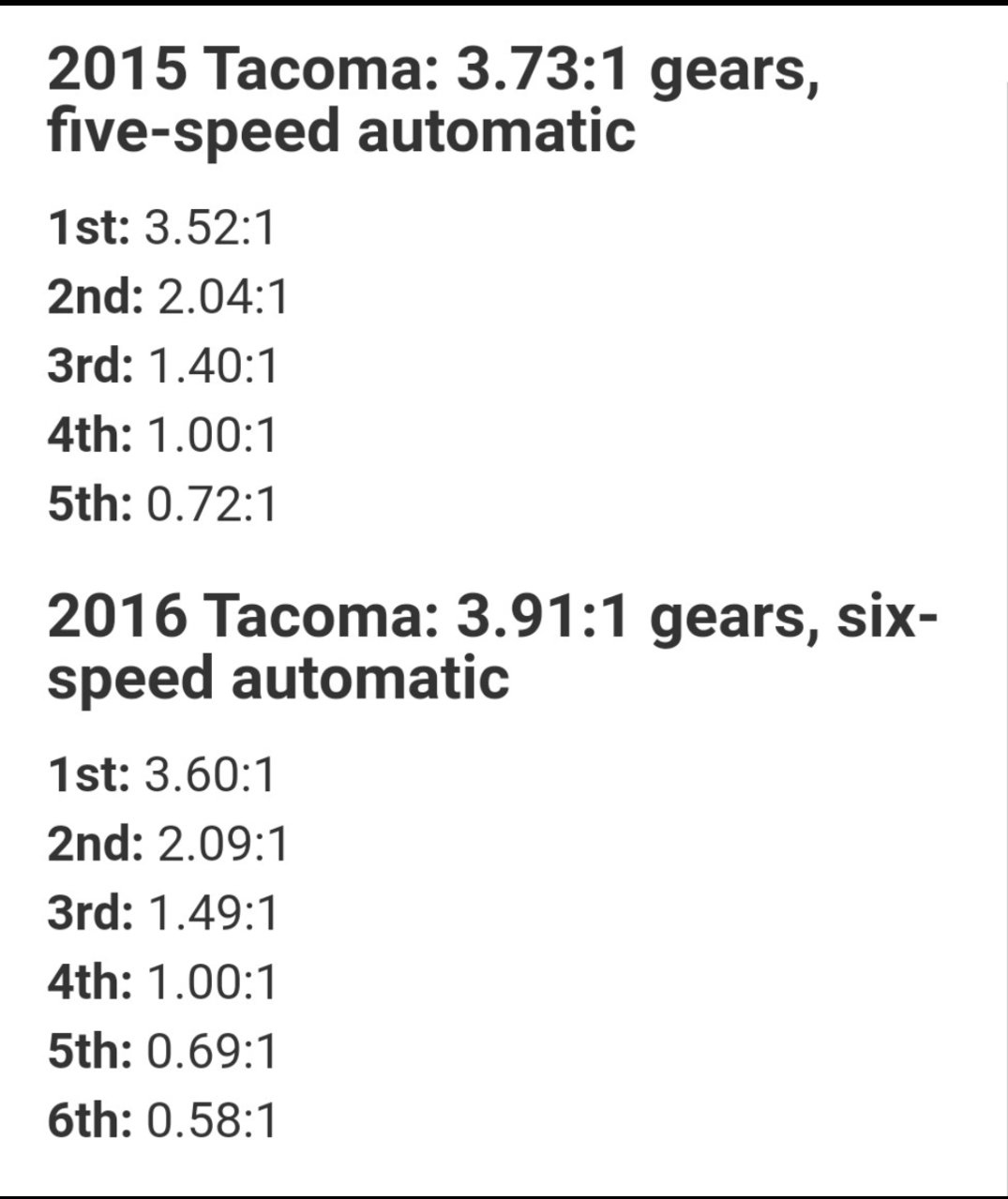

    This says it all:
    Until Toyota COMPLETELY overhauls their transmission, I will not be looking to buy another. I'll stick with what I built.

    2015 running 50mph in 5th gear: 1474 rpm
    2016 running 50mph in 6th gear: 1245 rpm
    2016 running 50mph in 5th gear: 1481 rpm
    The solution is simple.
