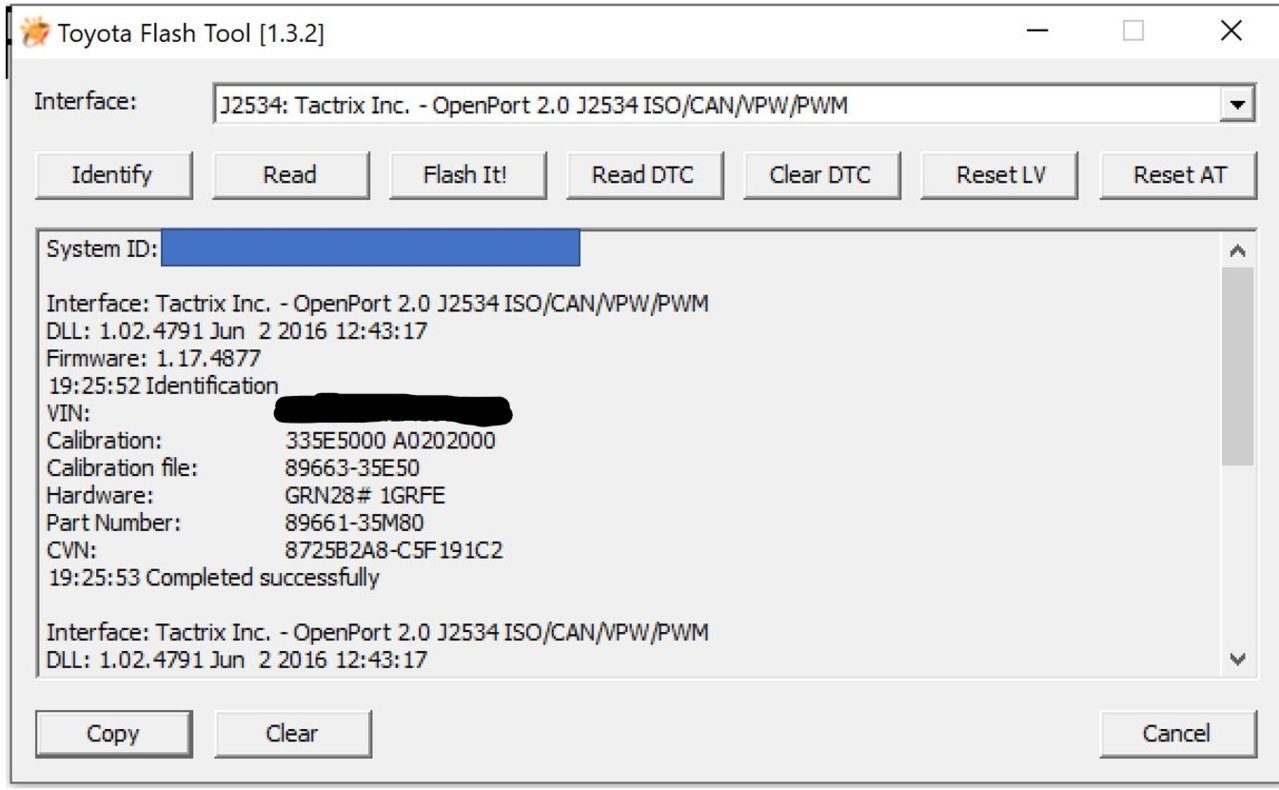

  19. May 5, 2021 at 7:33 PM
    BortisYeltzen
    BortisYeltzen Well-Known Member
    Dec 17, 2016
    #205105
    1,261
    Barrett
    Salt Lake City, UT
    2017 MGM TRD Off-road DCLB
    OTT Tuned, Bilstein TRD Pro lift, ECGS bushing, Heated Clazzio's, RCI SKID TRILOGY, BAMF sliders, ARE V-Series shell, RokBlokz flaps, more to come
    @OVTune when can we expect other T4R ECU's?
    Below is my 2021:
