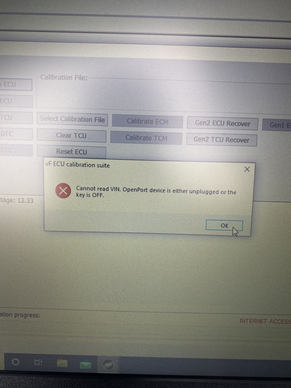

    Was flashing my truck back to OV & it gave me an error 0.0.01 or something like that and then now I keep getting this? Everything is plugged in properly but it keeps saying it isn’t. Thoughts? Truck won’t turn over now.

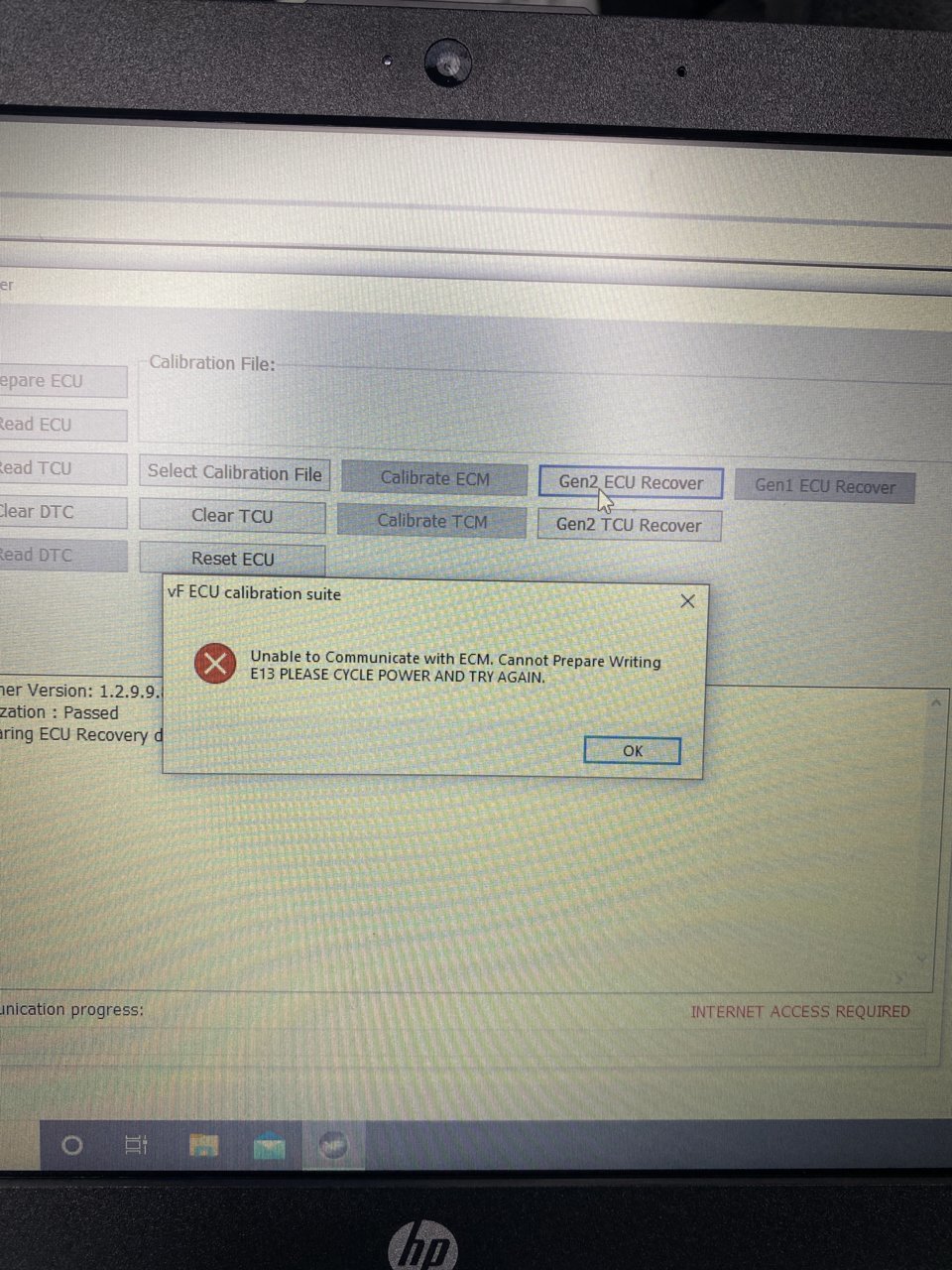

    OTT 7.0

    Close and re-open VF tuner. Open the flash tool. Do not click "prepare ECU". Select the stock file for your truck from the VF tuner installation directory. Turn on your truck but don't start (as usual). Click "Gen2 ECU recover". Let me/us knoow if it works. If it does not, you will have to remove your ECU for a bench flash. PM me if you get to that point, I can do it for you.

    Thank you, this worked & I was able to recover the ECU. It still wouldn't turn over when I tried to start the truck though so I had to reflash the tune that had failed & it successfully started after that.

    That's good news. Still wondering why the recovery option didn't work on mine. Makes me very leery of trying to flash another tune. Thankful I'm on a tune I really like. Lapoltba to the rescue again!

    Sometimes a brick happens which is odd. Typically the recovery feature works, rarely has it not.
    I’ve noticed on VFT files installed through the new version of the software tend to have the most brick events.
    When people reach out to me and I help with recovery, I suggest that they open the vft files in VFTuner and export them. This makes it a VFC and has less issue.
    Just another reason people should download the newer updates
