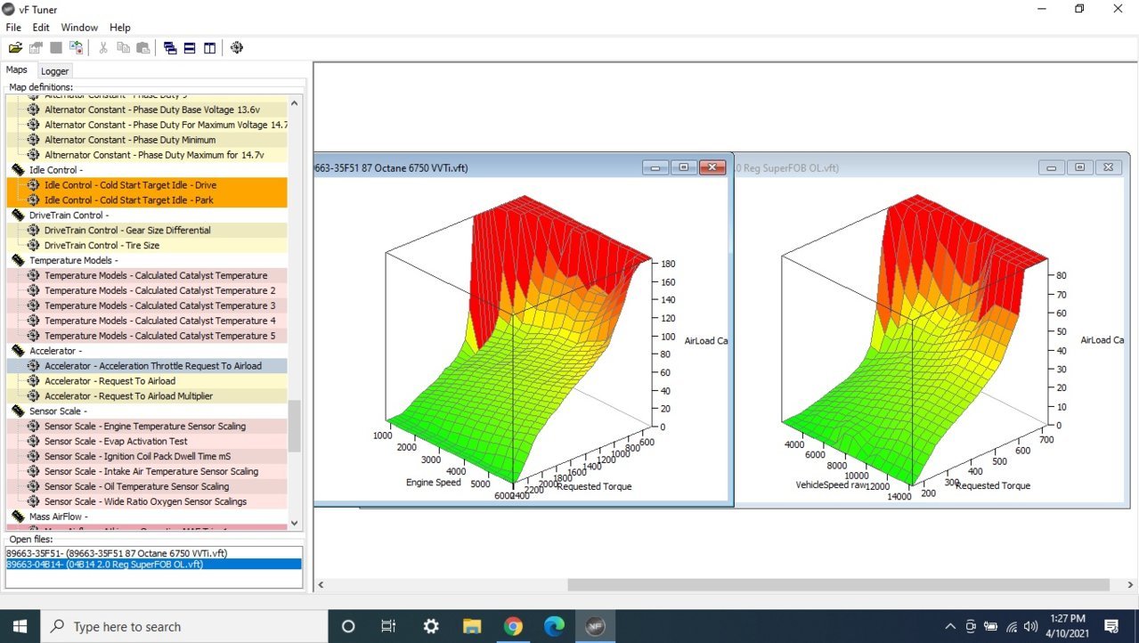

    Also something I didn't ask about last time was why in the 35F51 (4R) A-ACAT table (pictured in the quoted post), the Requested Torque axis also has values that start high and reduce down to zero, and then rise again.

    That was in reference to something separate that @MOC221_ was asking about, WRT to the vehicle speed axis for the 3GT A-ATRA table
    Unless I'm retarded, I'm asking about the relationship between the tables between 3GT and 5T4R, since they look super similar but have different descriptions and table axis', and why the 4R has an axis that starts with values greater than zero, trends down to zero, and then rises again.

    3GT - 3rd Gen Tacoma
    5T4R - 5th gen Toyota 4Runner
    A-ACAT is in reference to the table for the 4Runner that is titled "Accelerator-Acceleration Calculated Airload to Torque"
    A-ATRA is in reference to the table for the 3rd gen Tacoma that is titled "Accelerator-Acceleration Throttle Request to Airload"
    These table acronyms are also spelled out in my original post from early April for clarification. I only abbreviated them following that

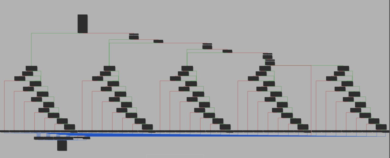

    Map switching Flow Control
    all coding is done. Mapping is done.
    lets get this released.
    PDF Docs on how it works next week!
