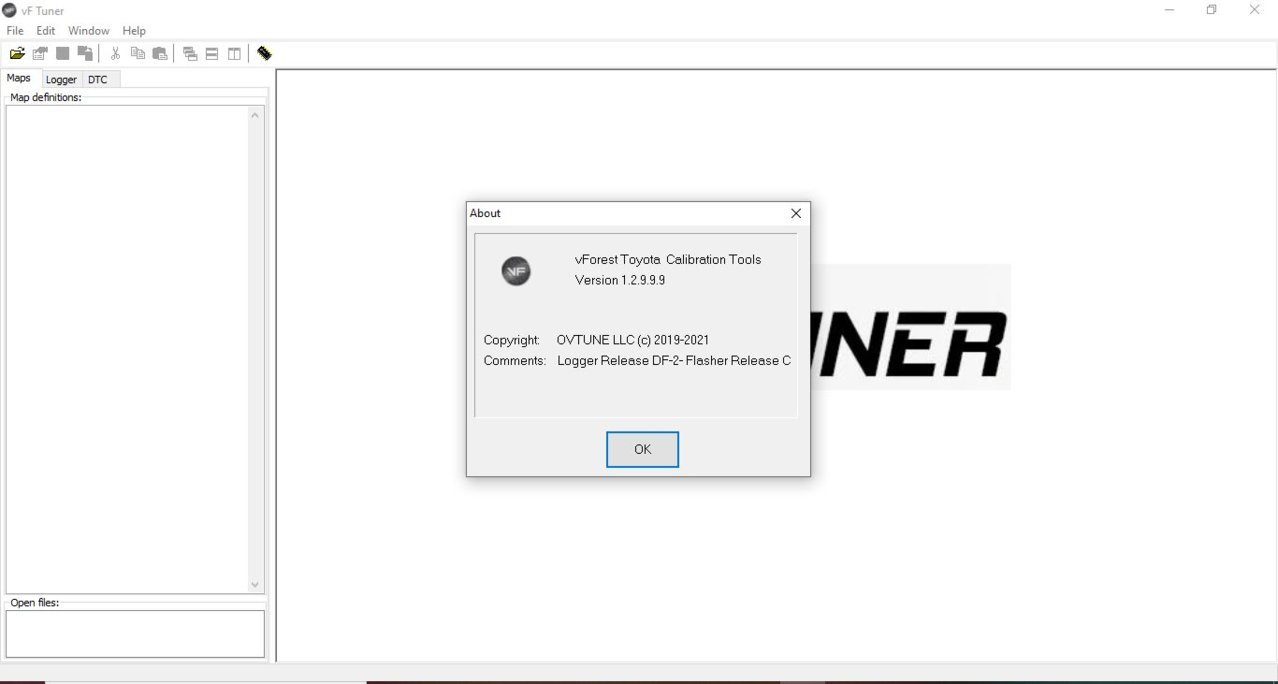

  2. May 14, 2021 at 5:28 PM
    N5J_Taco
    N5J_Taco Well-Known Member
    Oct 29, 2020
    #345235
    331
    Correct it says that BUT you down load 1.2.9.9.9...I just did!

  4. May 14, 2021 at 5:29 PM
    NickJacq23
    NickJacq23 Well-Known Member
    Nov 13, 2018
    #272576
    322
    good question, so now .vft files won’t work?

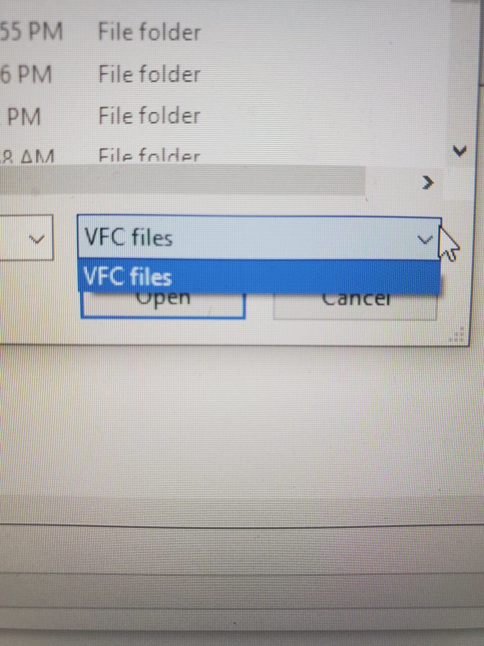

    Sold: 2017 TRD OR/2012 TRD Sport
    Mat has said it would work/support .vft, I'm just trying to make sure I'm not going about this the long way.

    The drop down doesn't list .vft, just .vfc

    331
    In my experience any .vft file can be opened with the new software 1.2.9.9.8 and now 1.2.9.9.9. When you go to save it the program automatically converts it to .VFC making it safer to flash and recover ECU if necessary.

    OVTune
    Ok. I'll make sure that is working when we release the update for the Tacoma. Should be showing....
    If possible I would recommend convert your old file to VFC.
