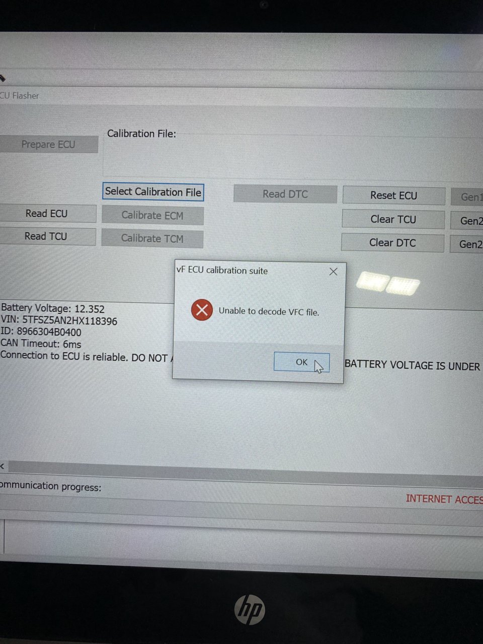

  16. May 15, 2021 at 6:48 PM
    Idahotaco88
    Idahotaco88 Well-Known Member
    Nov 13, 2018
    #272568
    334
    Steven
    2017 black AC OR
    Kings 2.5 with adjusters, icon rxt stage 2. SCS stealth blue on 35s
    F076524A-6BAE-4698-A72A-C43FCA4294DB.jpg @OVTune
    Anyone having this issue with 1.2.9.9.9 yes I have internet
  17. May 15, 2021 at 7:30 PM
    OVTune
    OVTune Well-Known Member
    Mar 27, 2017
    #214557
    8,112
    OVTune
    Show me the file would be helpful
  18. May 15, 2021 at 7:40 PM
    Idahotaco88
    Nov 13, 2018
    #272568
    334
    Steven
    2017 black AC OR

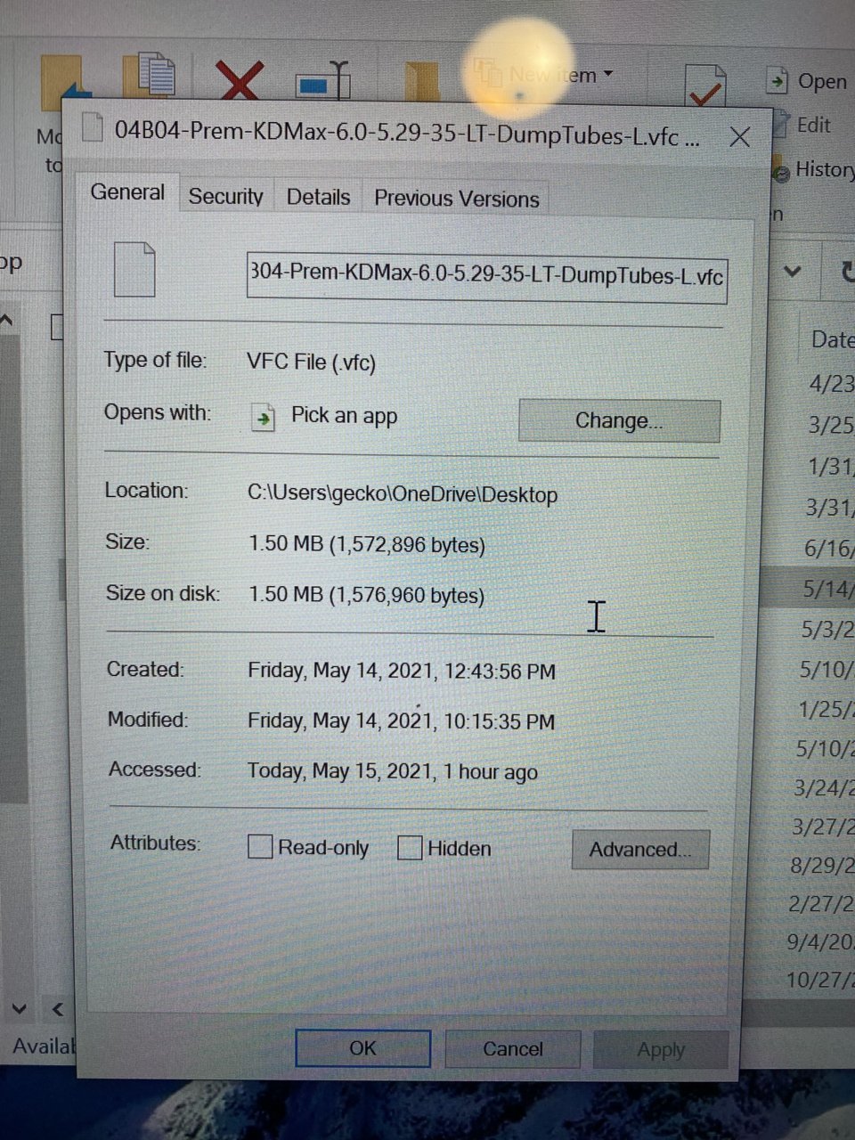

    This what you mean ? I can flash my own tunes but not this one. Was originally vft.
  19. May 15, 2021 at 7:44 PM
    OVTune
    Mar 27, 2017
    #214557
    8,112
    OVTune
    Was it actually properly converted to VFC? Or just changed the file extension. Because that doesn't work.
    Did you make the file or was it sent to you like that?
    Open it in VF Tuner and export it.
    Email me the file and I'll see why this is occurring.
  20. May 15, 2021 at 7:44 PM
    Idahotaco88
    Nov 13, 2018
    #272568
    334
    Steven
    2017 black AC OR
    I believe I got my answer from @TWTaco
    Being updated tomorrow
