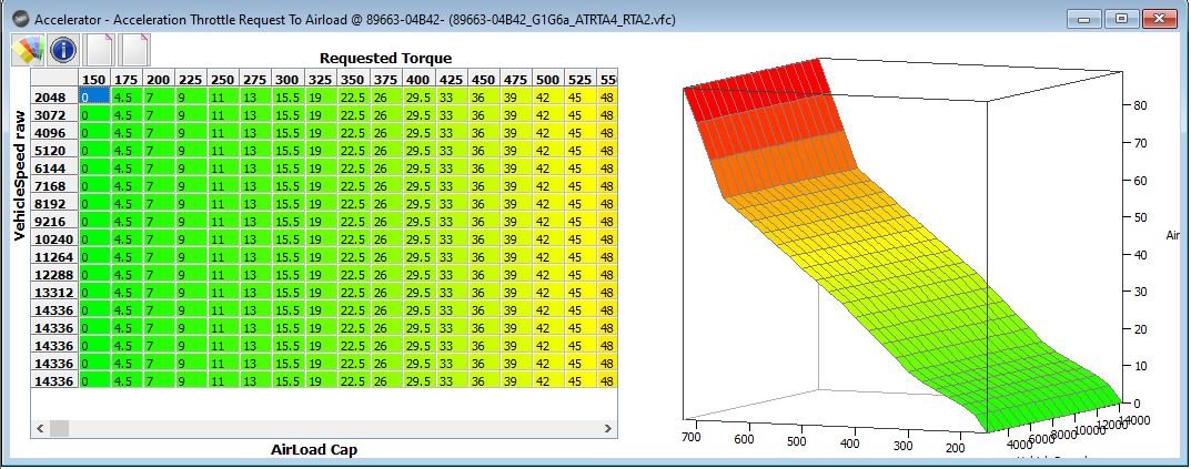

    We want to let everyone know that when 1.3.0 releases, some tables (naming, info, scaling, etc) will change. The purpose is to make the tables more accurate, easier to understand, etc.
    Some of the structures will change.
    For non pro users, some of the tables will be going away. (mostly development level stuff, nothing that you'll miss. 99.99% of the general population would never touch anyway).

    Hallelujah.
    WTH is a negative % torque anyway?!
    Is that for reverse? :)
    Wait.. or does that indicate reverse power flow when at full lift WRT the PTET Primary Map? More negative values give better engine braking..

    3.5 2GR-FKS.
    Primary Throttle Efficiency Target
    Oh never mind, just release the kraken lol!
    WRT = with respect to
    I've just about had my fill of playing with *yawn* stock calibrations anyway laugh out loud.

    Here's my edit.. do I get a gold star?
    By the way, when you @OVTune said to divide that raw veh speed by 128, was the result in mph or kmh?
