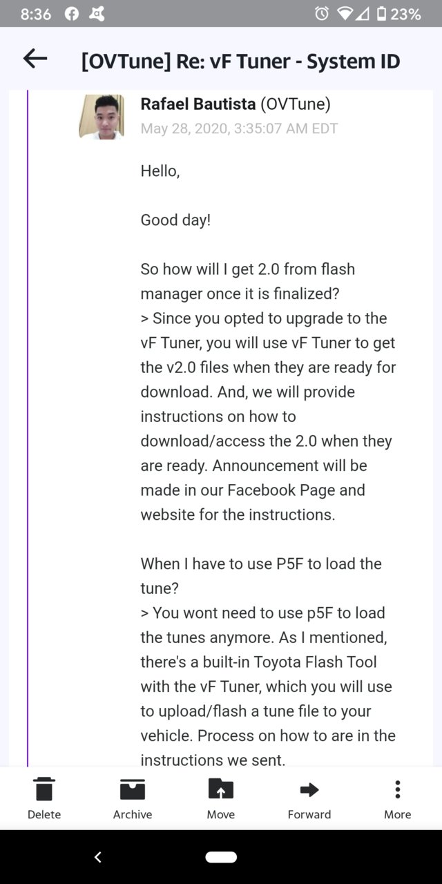

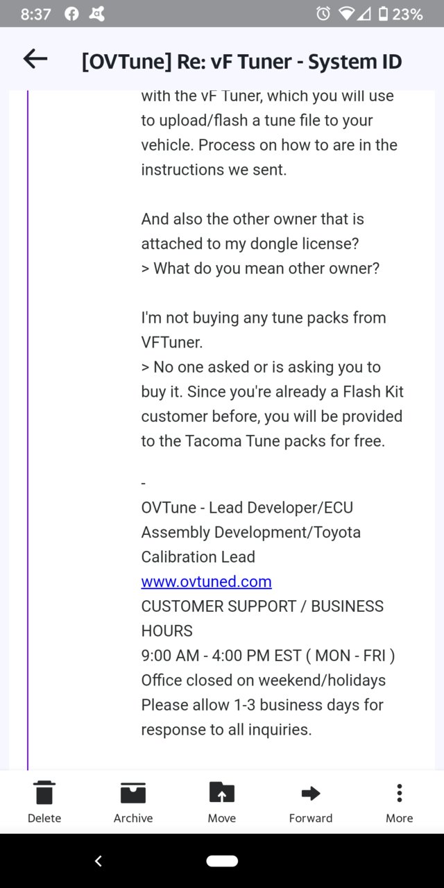

    Yeah that seems confusing. Those of us who traded in our dongles got a p5f reg file from Mat, separate from vF and the vF Master Key

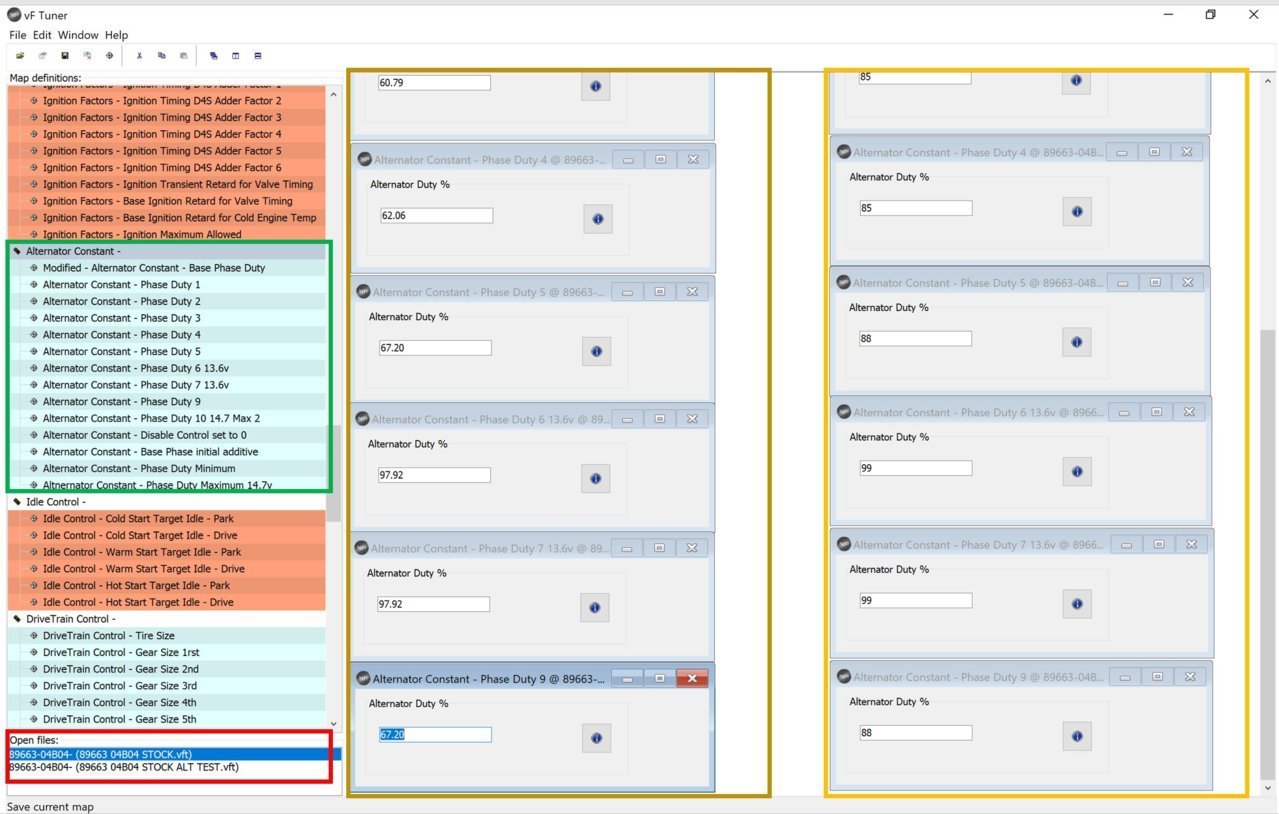

    According to what I have seen if you run basic lighting with some added lights you don’t use all the time this “should” work fine. The group on the far right is for an AGM according to a member that posted earlier in the OVTune thread. I just want to see if anyone had the same results.
    The one on the left is stock.

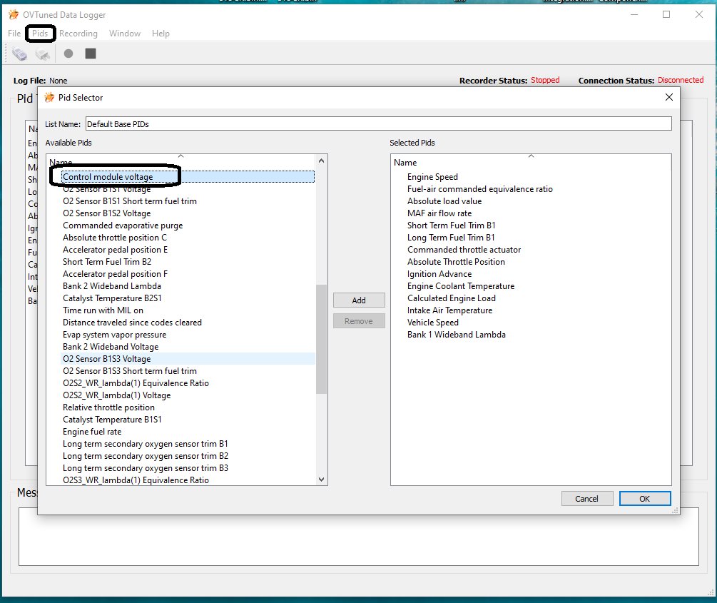

    To quickly check your voltage after flashing
    open the logger
    select PID Control Module Voltage
    and check the value​

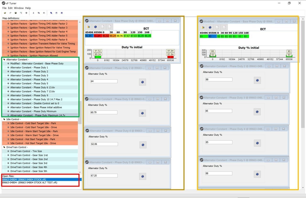

    Those are screen shots I posted in this thread a while back. @OVTune, all you need to change is the items you show in the post I quoted above? Why were so many different in the test tune you posed that I used to compare in the images posted above?

    Use the flashing tool in vFtuner to flash any p5 file that's compatible with your ECU. It's essentially the same as the stand alone flash manager from before.

    Word of advice,open flash manager and do the usual routine to download the file you want and note the location of the download (usually in C/: users) Then open VFTune and click the "flash it" button and the flash program will open,select tune as usual from there.
