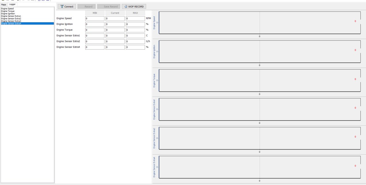

    We will have a new update soon for vF Tuner
    - All new built in datalogger
    - WOP recording function
    - Alarm sets for logging
    - Live graphs
    - Direct RAM access logging
    and much much more
    and you can switch to the logger right from the map / logger tab

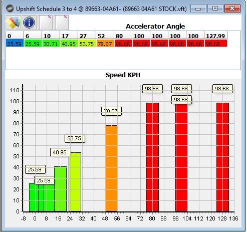

    Hi everyone,
    I have what might be a few dumb questions on editing shift maps in vF Tuner. The image below is the shift map table for my ECU. I believe one row is speed in KPH, and the other is accelerator angle, in units I cannot figure out. Which row is speed, and which is accelerator angle? i.e. am I editing speed as a function of accelerator angle, or am I editing accelerator angle as a function of speed? What are the units for accelerator angle? Also, why are there four columns in the table for "100"? Is this a relic of Toyota's shift maps? If so, no wonder this truck drives like a blind toddler trying to do his first puzzle.
    SuperBad likes this.

    Accelerator Angle is the axis ( the ones with the 100, 100, 100, 127.99) and YEP that is how toyota sets up the axises! So actually anything after the first "100" is NOT USED!
    There will be an update later that allows you to edit the axises.
    So how it works is @ "27" (Accelerator angle) the transmission will shift @ 53.75 (speed)
    Increasing the speeds (numbers in green, yellow, red) = holding gears longer before shifting
    decreasing the speeds (numbers in green, yellow, red) = Shifting sooner

    Got it, thanks for the prompt reply! Looking forward to future updates, this program will be very cool.
