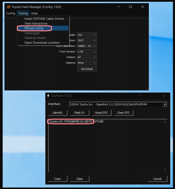

    I'm trying to get my .REG file, but OVtune says they need my system ID. How do you get your system ID without your .REG file? I'm so confused on this stuff.

    Just open the Flash Tool. It will show your System ID in the window (ignore the grayed out buttons). The System ID is of your tuning computer only, not your Taco.
    This is from the OG Flash Kit Instructions, but similar in vF:
    moondog1[QUOTED] and Shellshock like this.

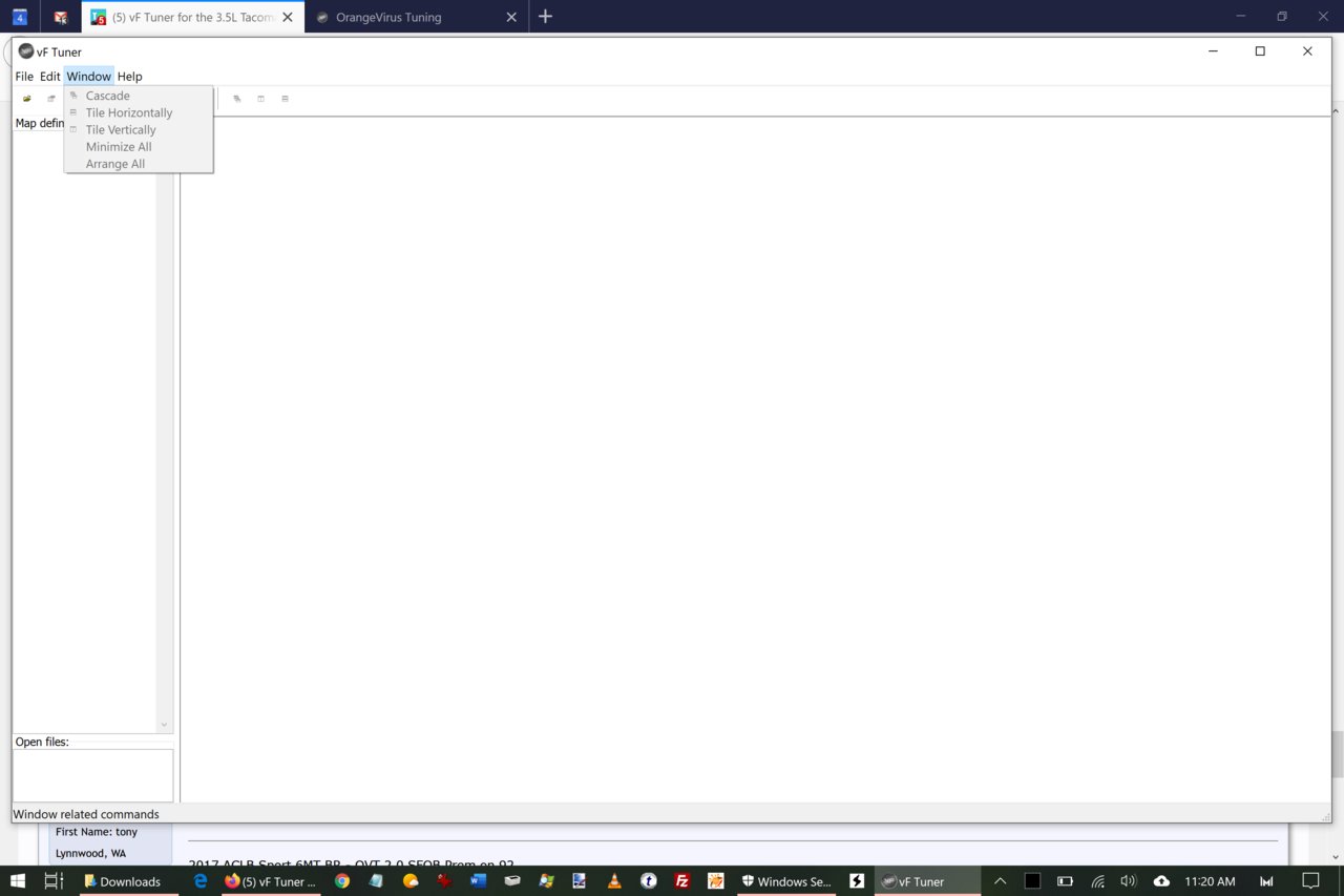

    i'm also having this issue. there is no Toyota Flash Tool in vF here. all options are greyed out except Open, Open CSV, and Download. and those do nothing. also, not sure i'm current. i had 1.0.0.0.12 installed, saw a mention of 1.0.0.0.13 and went to DL from ovtuned.com, and the DL was 1.0.0.0.11... now i'm super confused. ticket in with Rafael but no instructions are making sense.

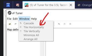

    Several buttons will be grey until you open a file.
    Click the GREY COG icon in vF Tuner, under "window" and it will open the flash tool.

    I don't know if the OVT site is updated, but this was the latest version posted:
    The Flash Tool only shows up in the vF toolbar as the gray cog symbol.

    The gray cog in the toolbar under here is the Flash Tool.
    You need to unlock an ECU and Open it to ungray those menus.
