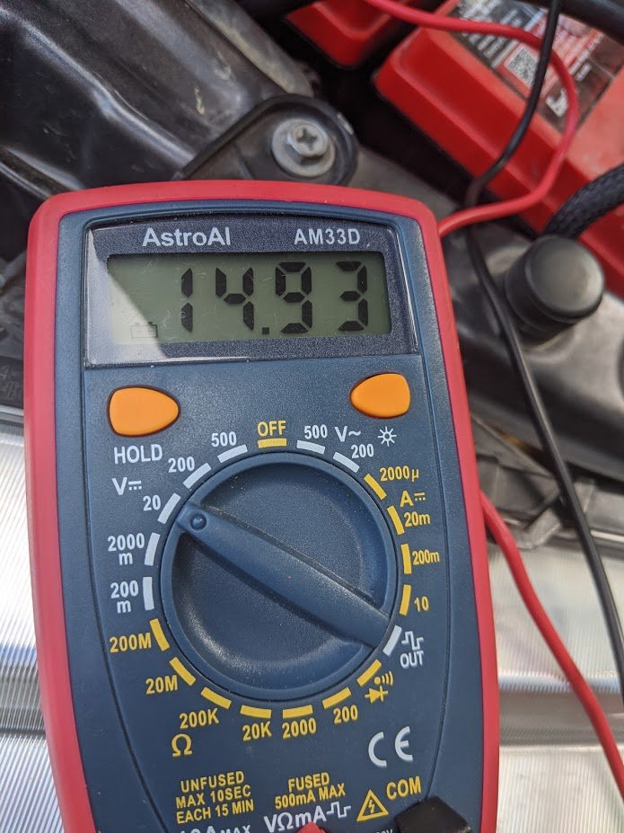

    @tonered inspired this.....
    After the previous alternator setting changed, here is what i see....
    OVTuned Data Logger
    VoltMeter on the battery
    O6hbJFLzmSrnkKAJi0-81emSxwYlhijbBncbtKFN_85cee221010aae135a4f124b02756d99b837308b.jpg
    From the bluetooth monitor on my starter battery
    e46_ema, ihatemytruck and tonered like this.
  10. Jun 5, 2020 at 7:35 AM
    #1490
    tonered
    tonered bartheloni
    Sep 25, 2017
    #231055
    31,331
    tony
    Lynnwood, WA
    :hattip:
    Just my opinion, but you might want to turn that down a tad?
    Also, remember that idle voltage is going to be lower than voltages above idle. They should be steady at about 1,200rpm and above, or something like that, when the R/R (or ECU in this case) shunts the excess charge.
    ihatemytruck and b3itz[QUOTED] like this.
  11. Jun 5, 2020 at 7:37 AM
    #1491
    b3itz
    b3itz Camp Life
    Mar 6, 2019
    #285589
    932
    Northern KY
    2016 MT OR DCSB
    Tuned, geared, armored, BP51s...
    Yep, exactly where my thoughts are. The voltmeter is the true number to me and it's too damn high!
    maybe 94 is the magic phase number?
    But interesting to see the bluetooth module directly on the battery read lower than the volt meter. I'm not surprised the ECU reads just a tad lower
    ihatemytruck and tonered[QUOTED] like this.
  12. Jun 5, 2020 at 7:38 AM
    #1492
    BortisYeltzen
    BortisYeltzen Well-Known Member
    Dec 17, 2016
    #205105
    1,261
    Barrett
    Salt Lake City, UT
    2017 MGM TRD Off-road DCLB
    OTT Tuned, Bilstein TRD Pro lift, ECGS bushing, Heated Clazzio's, RCI SKID TRILOGY, BAMF sliders, ARE V-Series shell, RokBlokz flaps, more to come
    Thanks for testing. If it were my truck, I’d tone it back a little and target 14.6-14.7 at the battery which appear to be acceptable low end charging for most AGM’s. My plan is to set it lower and drive for a few weeks at a time and hook up a charger now and then to see where the battery sits in charge %, then increase until I’m seeing 98%+ when I set it on the charger. Start low and creep up vs start high and burn down...
