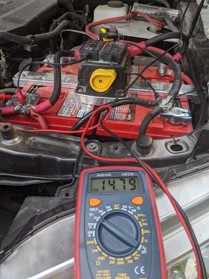

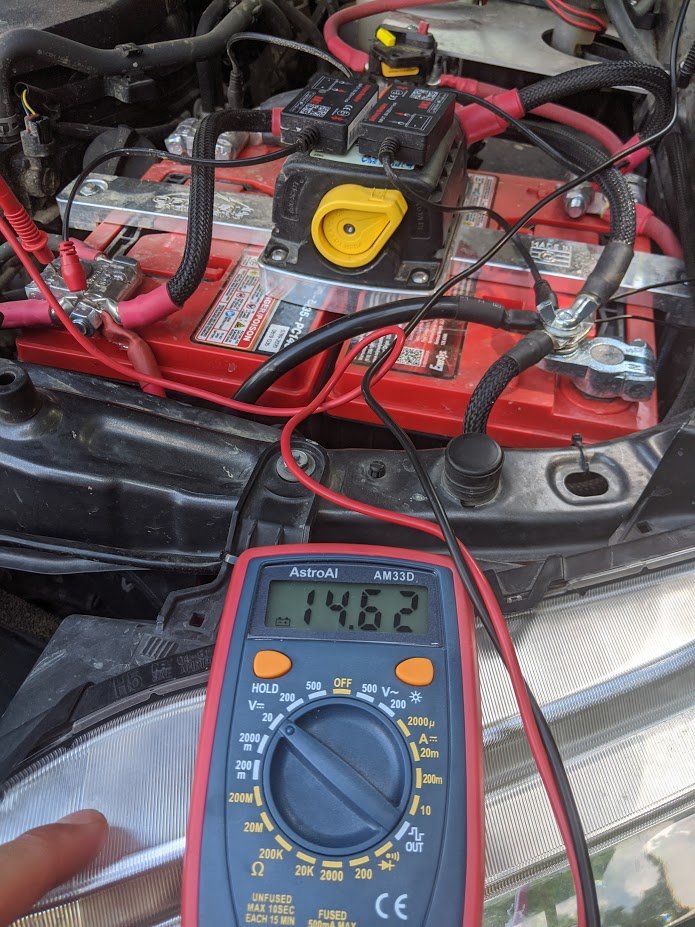

    I didn't know what an "AstroAI AM33D" was until I looked it up. Now that I found it for $12.99 on Amazon I think I'd put more faith in @tonered's meter readings. :thumbsup:
  14. Jun 5, 2020 at 10:32 AM
    #1514
    tonered
    tonered bartheloni
    Sep 25, 2017
    #231055
    31,331
    tony
    Lynnwood, WA
    Electronics have come a long way in recent years. Straight up VM readings shouldn't be a problem for most any DMM. Regaring AstroAI, I have their digi pressure gauge in my version of @Shellshock 's deflator / inflator kit. It is a solid unit, IMHO.
    Shellshock likes this.

    Yeah i think a meter reading on the battery is the right way to go to get the most accurate numbers.
    the data logger, my bluetooth monitor, torque, and my voltmeter all said something different, of course :)
    tonered likes this.
