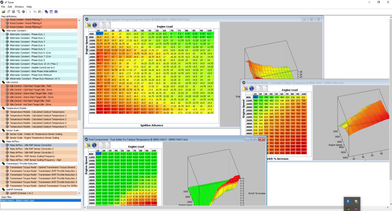

    My Tacoma is all stock with the 04A61 TSB stock tune. Can I retrieve my Tacoma's stock tune and save it using vF Tuner? I want to be able to reload my Tacoma's stock tune if I ever decide to or I may modify my stock tune.
    I realize there is a stock tune available with vF Tuner, but I want to save the stock tune that my truck has in it from Toyota.

    Yes, you can use the 'read' button on the flash tool and 'save' it.

    Searching around, I can't find a definitive answer to this question: are there tune packs that are the same or similar to 1.05.1 or 2.0 available for the 04B04 ECU? I can see and download the stock tune file for this ECU in vF, but don't see anything else. I have OVT already, on 1.05.1, and just want to change the alternator output and duty cycle, but don't want to kill the whole tune just to change the alternator. I'm happy with 1.05.1, will be happier with 2.0, and don't want to change anything about those tunes aside from the alternator.

    you have to request the tune packs via zen desk. if you want 1.05 as well, include that in your message.
