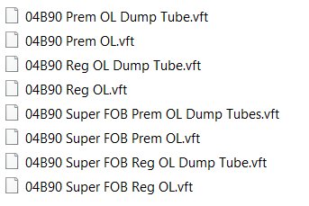

    Hey thanks for all the help everyone!
    Can y'all tell me a brief description or link me to which tune is which?
    Thanks!!!
    mZiggy, e46_ema and tonered like this.
  6. Jun 12, 2020 at 1:59 PM
    #1726
    tonered
    tonered bartheloni
    Sep 25, 2017
    #231055
    31,235
    tony
    Lynnwood, WA
    Any but the Dump Tubes. You don't have those.
    If it were me, I would try either 04B90 Prem OL (Base) or 04B90 Super FOB Prem OL (SFOB). They are octane learning with the initial settings up high and those Prem versions have a bit more ignition advance if you do run high octane.
    Those tunes will easily adjust to whatever is in your tank.
    moondog1[QUOTED] likes this.

    Is there a way to get 2.0 beta or final( not sure whats out) for my 04B90 6MT? Or is one of those in my tunepack and just named something else? Sorry for dumb questions.

    Those are 2.0 final!

    Oh thats awesome! For some reason the premium fob tune kept having errors. But the regular fob loaded first try. So that's what im running.
