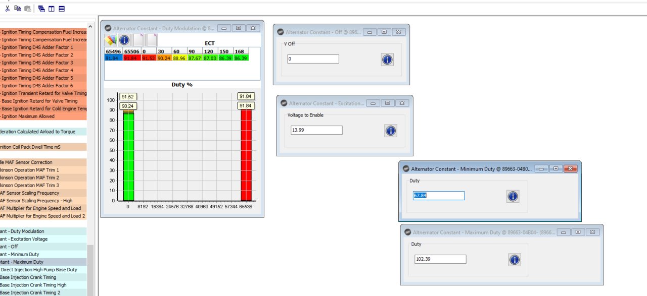

    Is alternator voltage control currently modifiable in vF tuner? Or is that coming?

    OVTune
    Stuff like this?
    Voltage for on, off state
    Duty
    Duty limits,
    etc
    (ECT axis will be updated and voltage is max )
    SC4333, TWTaco, inksin and 8 others like this.

    8,112
    OVTune
    ECU shows maximum charging volts is 14 FYI
    Guys with those other voltages will likely require higher voltage limit + Increasing duty
    TWTaco, BOMBS, wahoobie and 3 others like this.

    For AGM batteries, I believe we want an alternator charge voltage between 14.4 and 14.8. Are you saying that the 14 V limit can be increased if we increase duty?

    8,112
    OVTune
    You can change it just by setting the value higher. But you would want to also increase the duty for the added work
    Not all yet

    So if I already own a tune file and I get a license key for vF tuner I can just load up my tune, change the voltage for charging to 14.8V, save the file and flash the truck? If its that easy then Im going to walk around with a big smile on my face for the rest of the day.

    8,112
    OVTune
    most of them yes. However I need to pick more from my PO, which I'm planning on today.
    pretty much yup

    This keeps coming up because AGM type batteries require a higher voltage to keep sufurization from happening. Battery manufacturers recommend 14.6-14.8V IIRC. 2nd gen Tacoma owners could change the alternator output voltage by adding/changing a resistor/fuse under the hood, but the 3rd gen alternator output voltage is controlled via the ECU. If the ECU could be modified to allow higher charging system output voltage, then 3rd gen owners with AGM batteries wouldn't have to hook their trucks up to an AGM compatible charger every few weeks or so.
