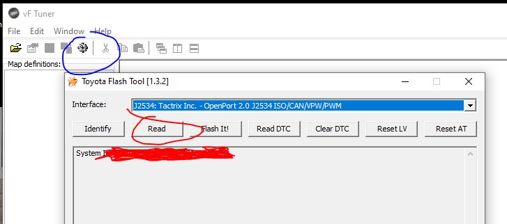

    Yes, you can read your Stock tune from vf, launch Toyota Flash Tool form the icon on the toolbar. Do the Read and Save it.

    Did you try to flash your saved OEM file? It didn't work.

    I have not tried flashing it. I did save it. But I also have no problem using OVTunes stock file

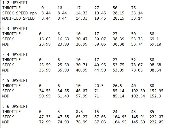

    Got some positive feedback on my previous post so I am going to add my modified downshift schedules to the discussion. I did not modify the 2-1 downshift from stock. I expect to further tweak both upshift and downshift schedules as I get more driving time on them. My typical drive is through winding, rolling hills, always accelerating up or down. FYI, the maps for 04A61 are labeled KPH in the speed column, but my testing says they are MPH. Yes, I sent a Zendesk ticket to OVTune on this.
