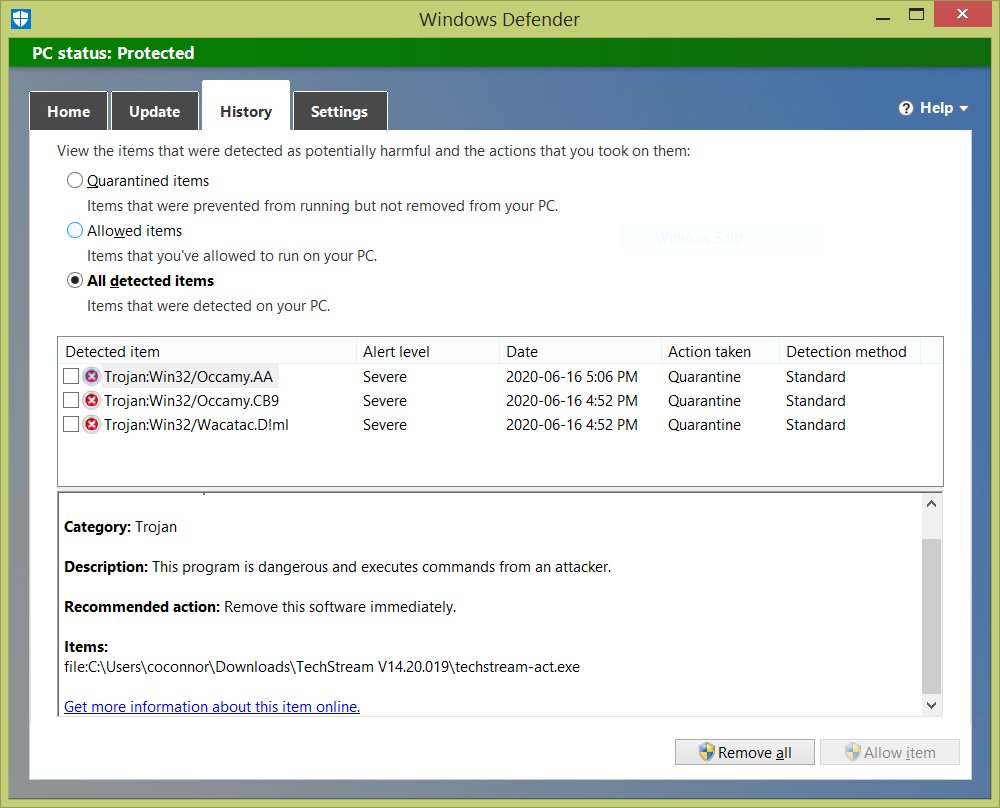

    Thanks. The version of techstream in tonered's signature seems to contain malware. What should I say to the dealer to get him to flash my ECU with 04a71?

    They all say that. It is from the key generator. It uses code obfuscation that triggers virus scanners. I'm sure if you download the one in my signature it will say the same.

    I see. Actually my computer quarantined the p5flash application for the same reason. I'm sure OVTune would not be distributing malware.

    I can tell you I have installed both versions and have not had issues. I would completely understand if you don't want to, but many people have used the files we shared as well.
