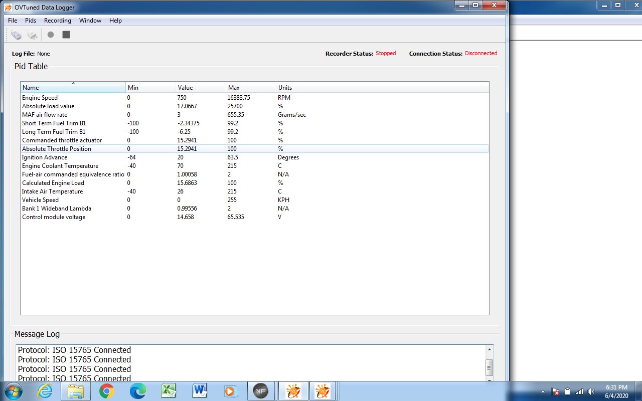

    Edit - already downloaded and edited the file in VF for the alternator output settings. Flashing now - will report back
    Edit 2 - all good. idling now after clearning LV and DTC values. Alternator showing 14.6 @ the ecu

    I set my ECT to 95. When I went to 96, I was getting 14.9 at the battery
