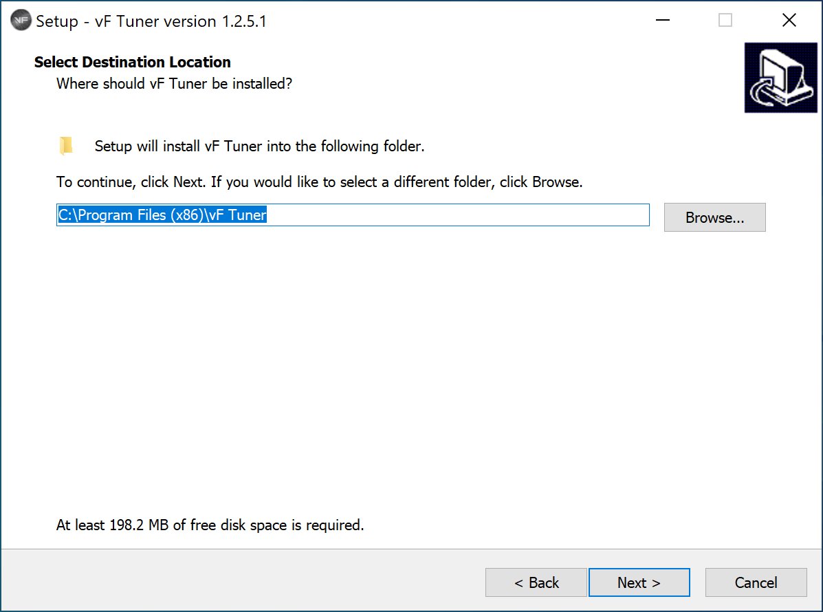

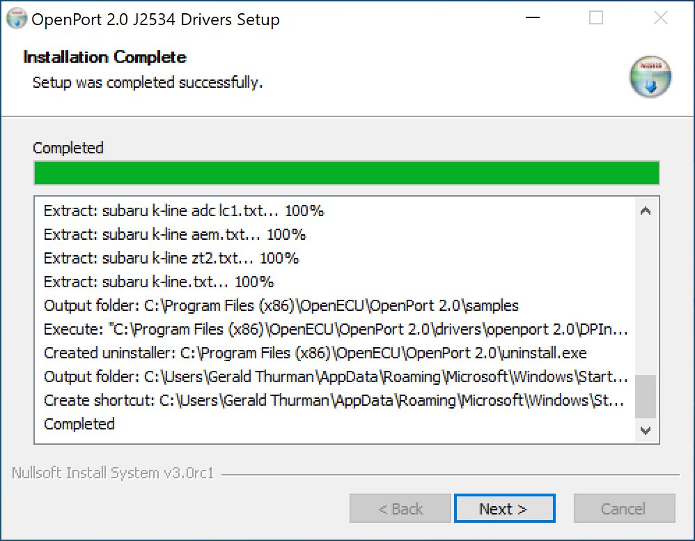

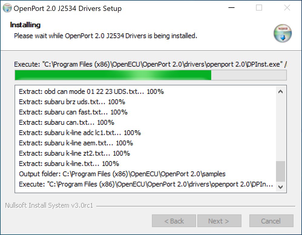

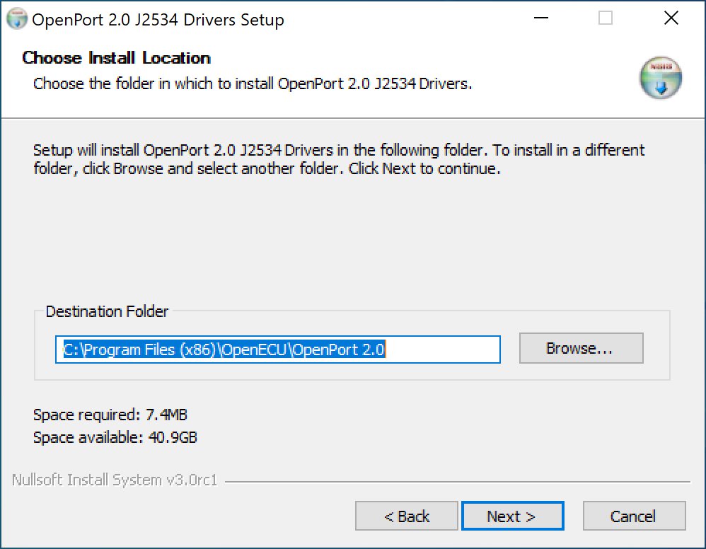

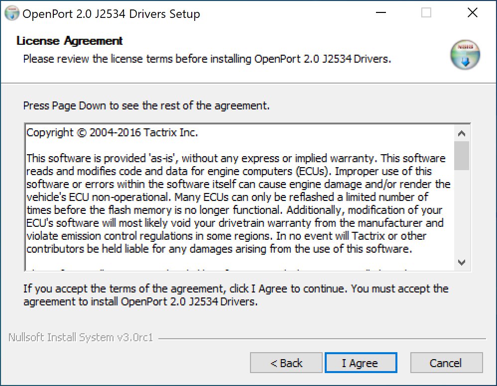

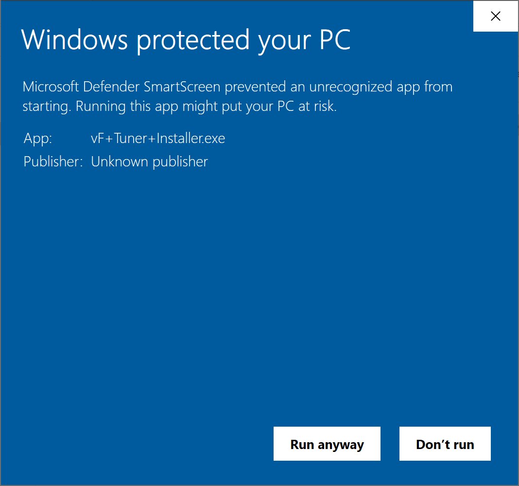

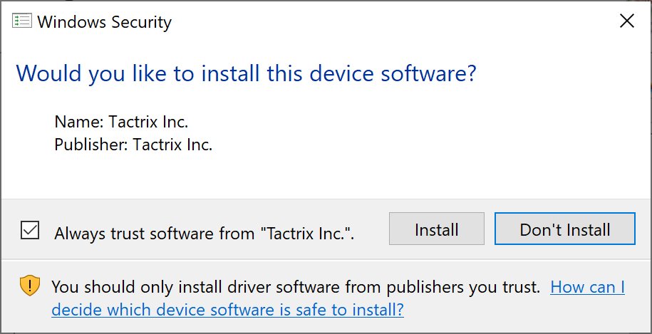

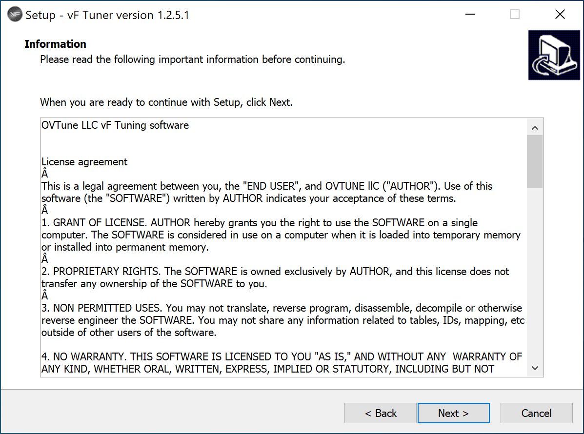

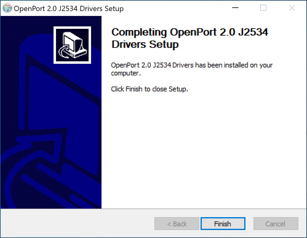

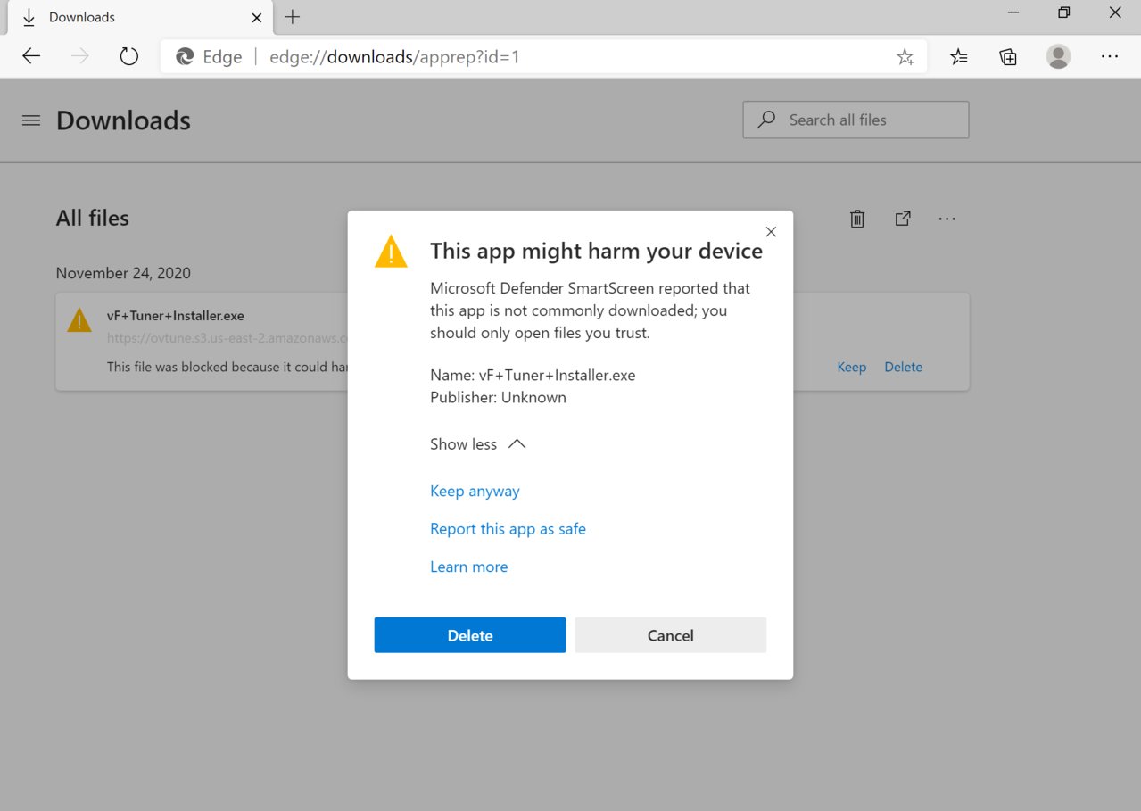

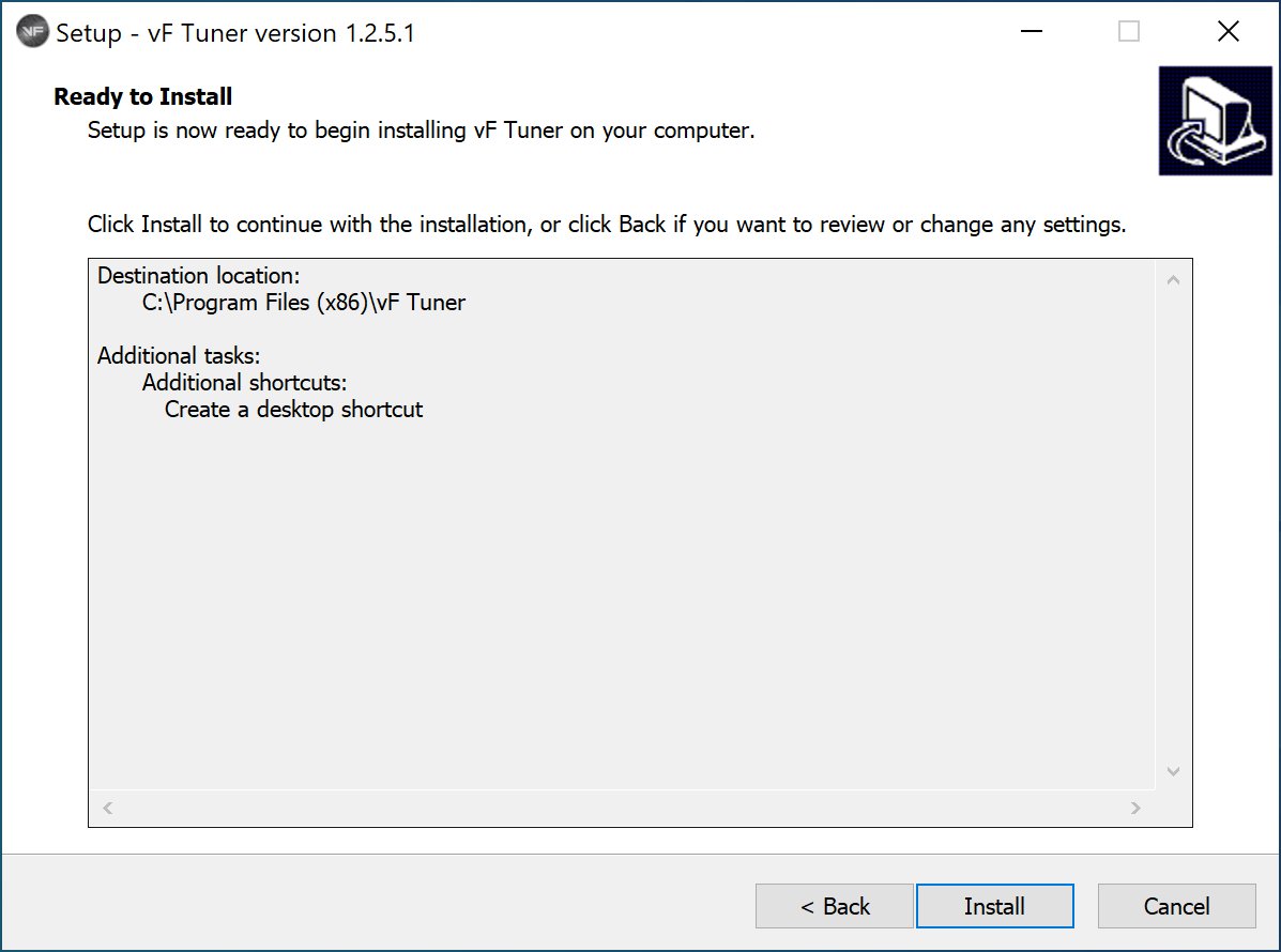

    1) Download software. Depending on your OS / AV /browser, you may get a warning. This is safe to ignore. Tell it to download and keep the file.
    2) Run the installer. If you get a warning, click more info and run anyway.

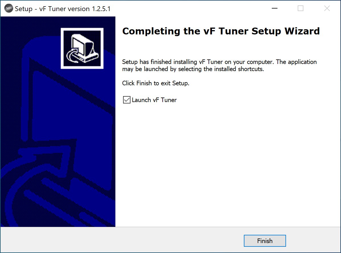

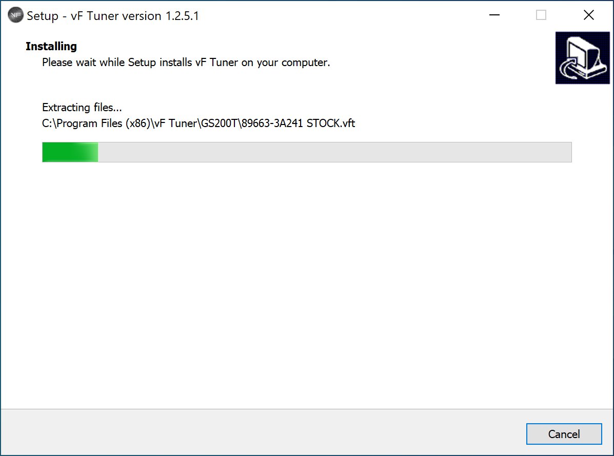

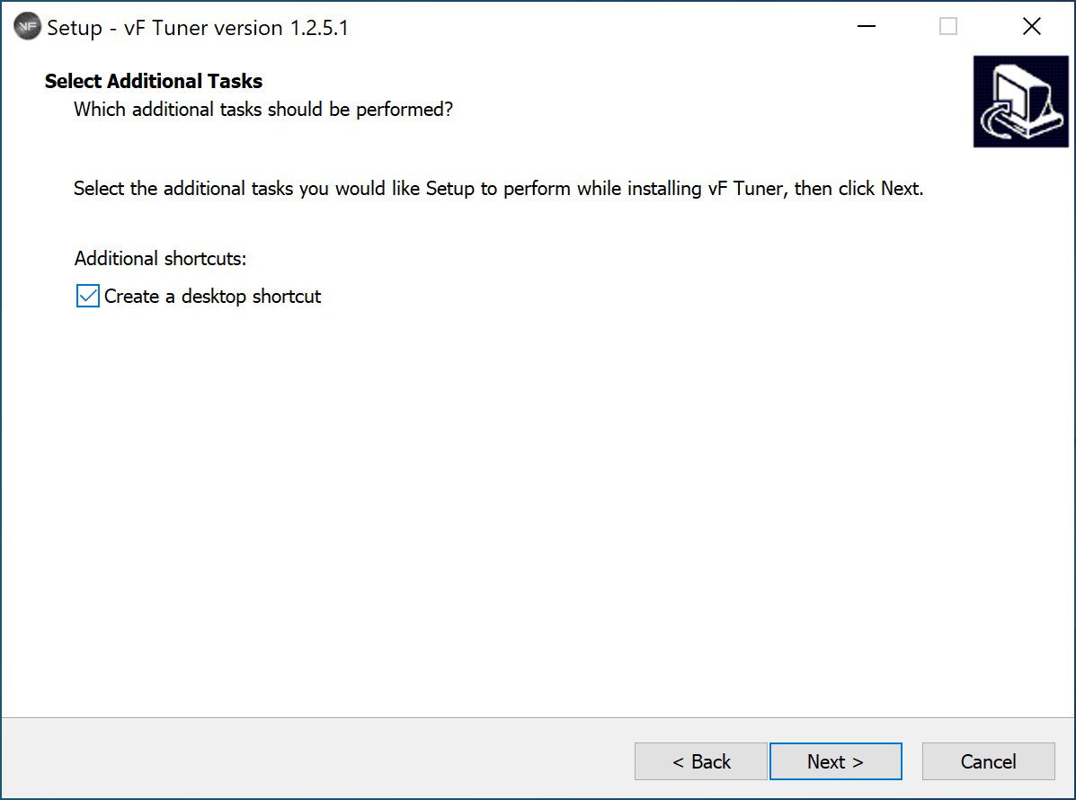

    3) Accept the license agreement. Next.
    4)
    5)
    6)
    7)
    8)
    9)

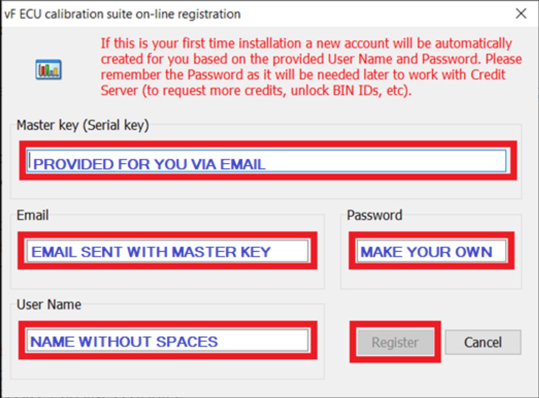

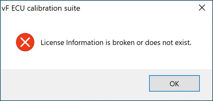

    10) You'll get a warning the first time you launch the application as you have not yet entered your license information.
    11) Make sure you’re online/connected to the internet during this part. A Master Key will be provided to you via e-mail. The email which received the master key will be the email you must input in the “Email” box. You will need to enter a password of your choice (don't forget it), and username (no spaces). The “Register” button will light up when you have filled out all the boxes completely.

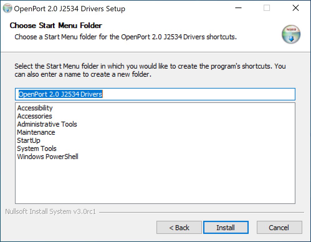

    1)
    2)
    3)
    4)
    5)
    6) Click install

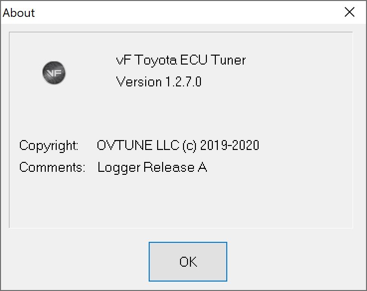

    Click about in the top menu bar
    c:\Program Files (x86)\vF Tuner

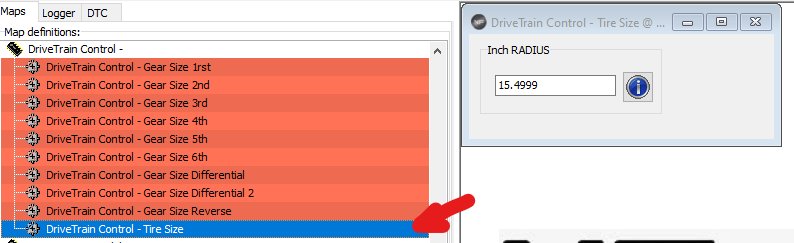

    My guidance for picking a tire size for the AT tunes:
    -- Always go to the next higher.
    -- Any tire different than stock, go 33.
    -- Any tire at 33 and not an SL sidewall (LT tires), go 35.
    -- If you have heavy 35s, edit the tune for 36s or 37s.
    The map input is the radius that you need.

    One last question--how do you find which gear size is the correct one, 4.88 vs 5.29? I'm having a hard time figuring out which I have.
  19. Dec 14, 2020 at 11:29 AM
    #19
    tonered
    tonered bartheloni
    Sep 25, 2017
    #231055
    31,061
    tony
    Lynnwood, WA
    You have 3.909 Stock. 4.88 and 5.29 are aftermarket gearing. All known 3rd Gen gearing info is in the link in my signature.
