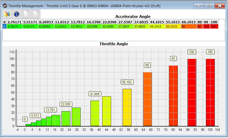

    I need to play with doing the same. Overall, huge improvement with 4.0. being one who constantly tinkers and fiddles I think I'm going to play with the throttle and even the shift points, mostly 2nd-3rd shift.
    Is this the only table/map necessary to adjust the "tip-in" or sensitivity of the pedal?
    I understood "tip-in" to be how much fuel was injected when large throttle changes were made to compensate for the change in MP & air mass entering the cylinders before the actual measured parcel got to the intake port. Since air is compressible, there was some amount of time that could be compensated for on big throttle changes to keep from getting a lean charge into the cylinder.

    That was just the 6th gear throttle map. There is one for all gears. Yes, there are more factors for "tip in", Throttle and Airload are the main ones.

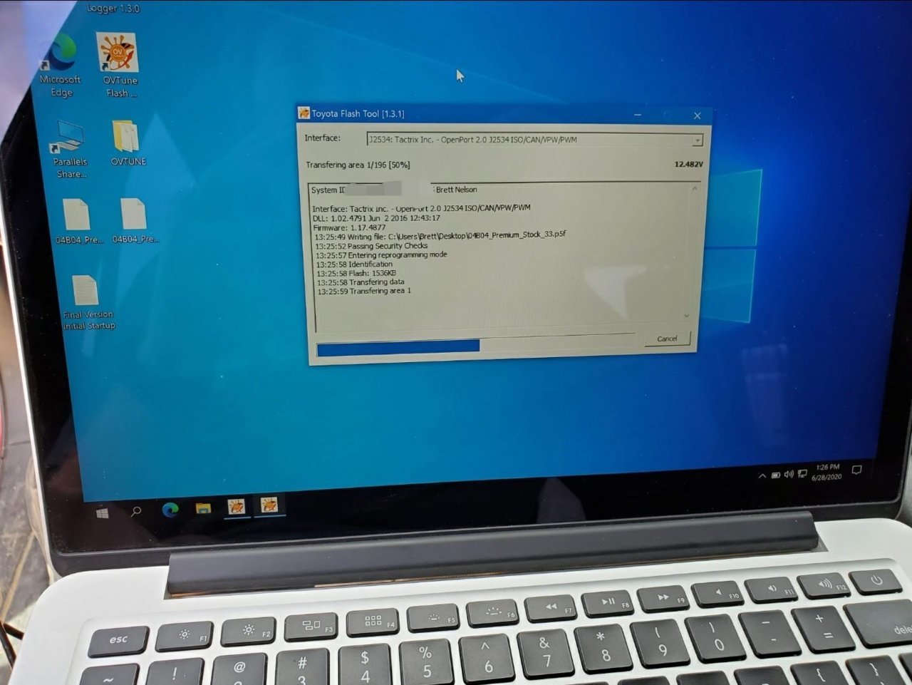

    Man, y'all need to hold off on those great reviews until I can flash mine! Haha. Got a Zendesk email in, my darn System ID changed on me when I moved my VM to a new host. Might just have to see if there's a newer system out there that doesn't require the old .reg file, but until then... Guess I can get around to replacing my even-more-cracked thanks to -20 degree winter weather windshield in the meantime.
    I'd love a way for it to be account based rather than machine based since my devices have a tendency to change often. Sounds like I'm actually best off using the wife's laptop for tuning because it never changes (it turns 10 this Christmas). It does sound like such a solution is being worked on however.

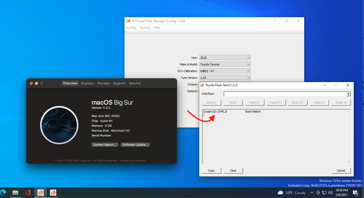

    It's System ID based, which unfortunately even with the same Virtual Machine and same Windows license and virtual hardware even, the System ID is read from the host hardware so it ends up changing. Though I have no idea what it actually is reading from, or I'd love to find a way to keep it static! I moved from a 2013 MacBook Pro to an M1 Mac Mini - of course this broke Parallels entirely as this is ARM based hardware so I threw it on a new(er) 2018 MacBook Pro I use for work to keep the VM from my 2013 Mac intact (X64/Intel based).
    Shockingly, with some X86 translation in the Windows for ARM VM in Parallels on my M1 Mac - I am actually able to install and open Flash Manager. But not VF as it complains about it running in a virtualized environment (so it is).
    This is that System ID thing that changes.
    It also means even if I want to go back and flash an 87 tune to save on gas, I cannot as the buttons are totally grayed out above because the .reg key is for another System ID. Bleh.
    For now I just wait. I'm hoping whatever tool is next in line to replace Flash Manager for us Flash Kit owners won't have this limitation. Or if I can get VF for free to use for flashing or discounted (since I just bought the $699 kit or whatever it was this last March) that would be super too. I don't really have the need to go around making lots of edits, thus why I went the flash kit route in the first place. Flash it and get updates over time was the idea. Now that there's community tunes that sweetens the deal, but only if I can actually flash them to my truck.
    So to answer the other question, yep, MAC address can be changed manually in Parallels, but it seems to pull from somewhere else than just that. But not sure exactly what that is myself!
